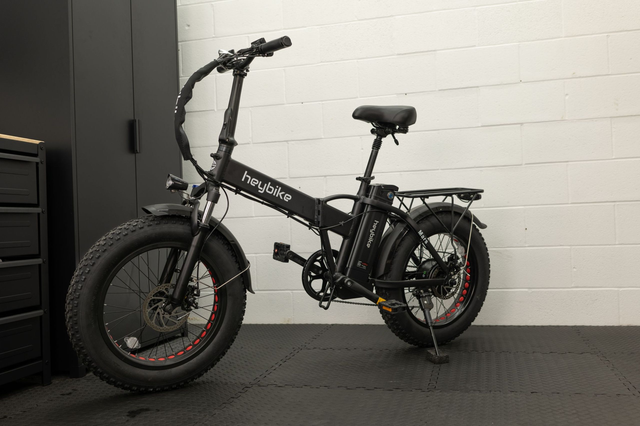

The Mars from Heybike is another budget folding e-bike. It looks similar to other folders we’ve tested, but there are a couple of notable differences.
For example, it has an external battery, rather than the typical frame-integrated battery pack, and what looks to be a more slack head tube angle.
Let’s find out how these differences impact the ride and user experience.

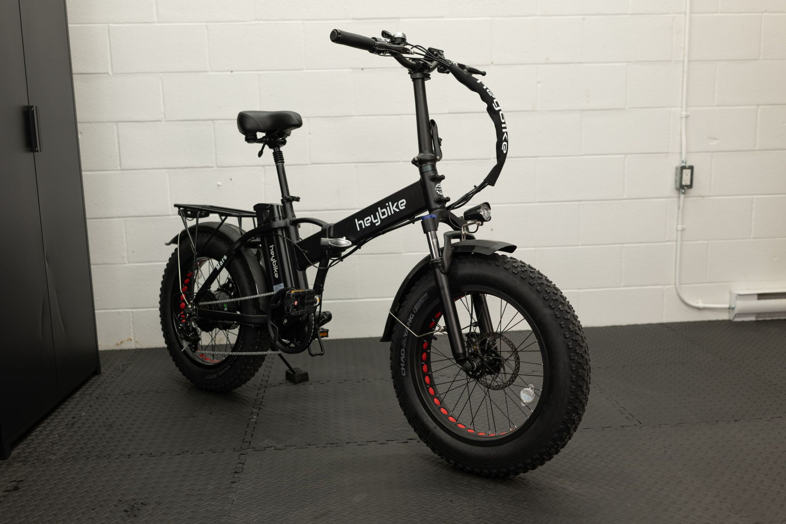

Heybike Mars diagonal view in BikeRide Studio

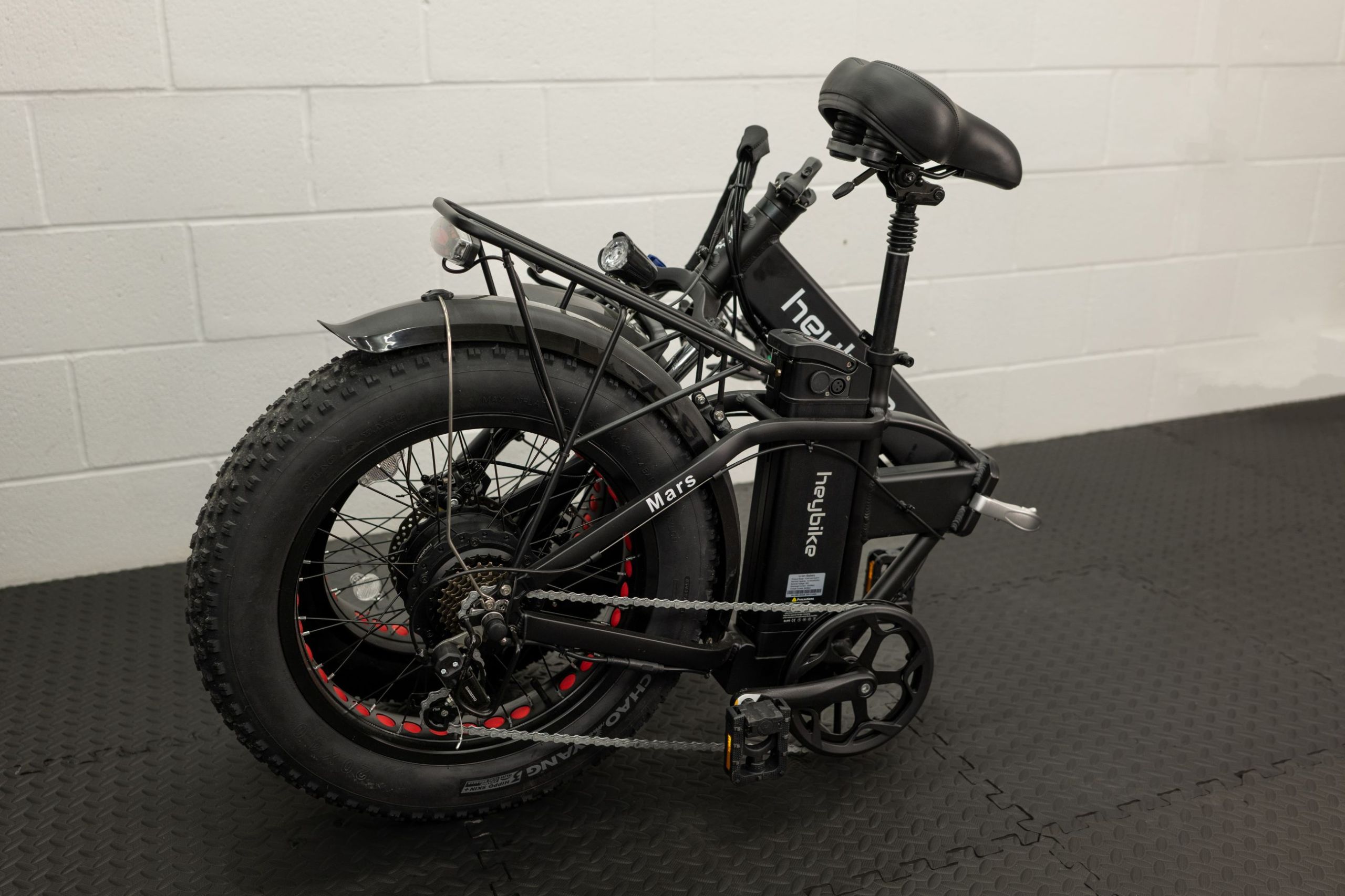

What Is the Heybike Mars?
The Mars is a folding e-bike with a focus on comfort. It has a height-adjustable handlebar, suspension seatpost, and 4″ fat tires. It also features a 500W motor and 600Wh external battery pack that should be easier to remove than integrated batteries.
There is a lot of competition in this segment, so the Mars will need something special to make an impression. Now, let’s see how it performs in our standardized testing.

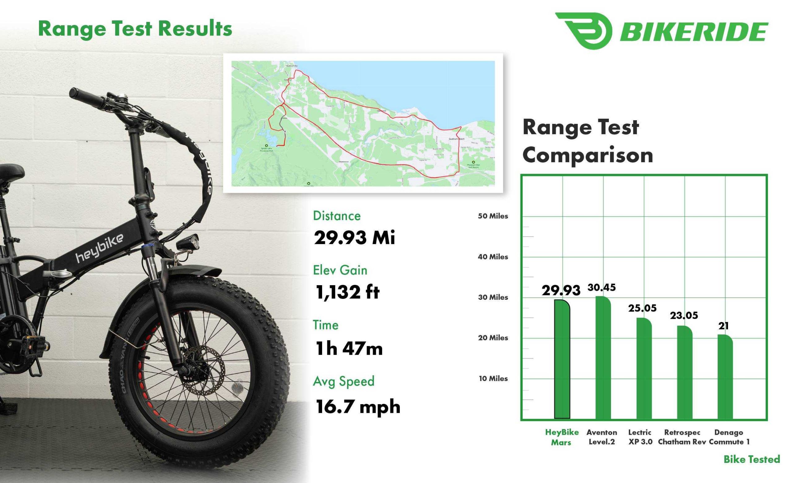

Range and Gradual Power Tapering
The Mars impressed in our range test, covering almost 30 miles and 1,132 feet of elevation. By mile 12 of the range test, the battery was already at two bars (~40%). However, it lasted another 18 miles before dying.
This is likely because the controller begins to limit the max power output as the battery voltage drops. The wattmeter, which initially peaks at around 750W, shows a steady drop in peak power output as the battery discharges. The power output gradually tapers off, unlike a lot of cheaper bikes, which suddenly shut off when they drop to a specific voltage. The motor provides 50W when it’s almost dead, which was a pleasant surprise, as I was left with some assistance to get home.
Despite the range anxiety noted, I was impressed that the 12.5Ah battery returned almost 30 miles of range.

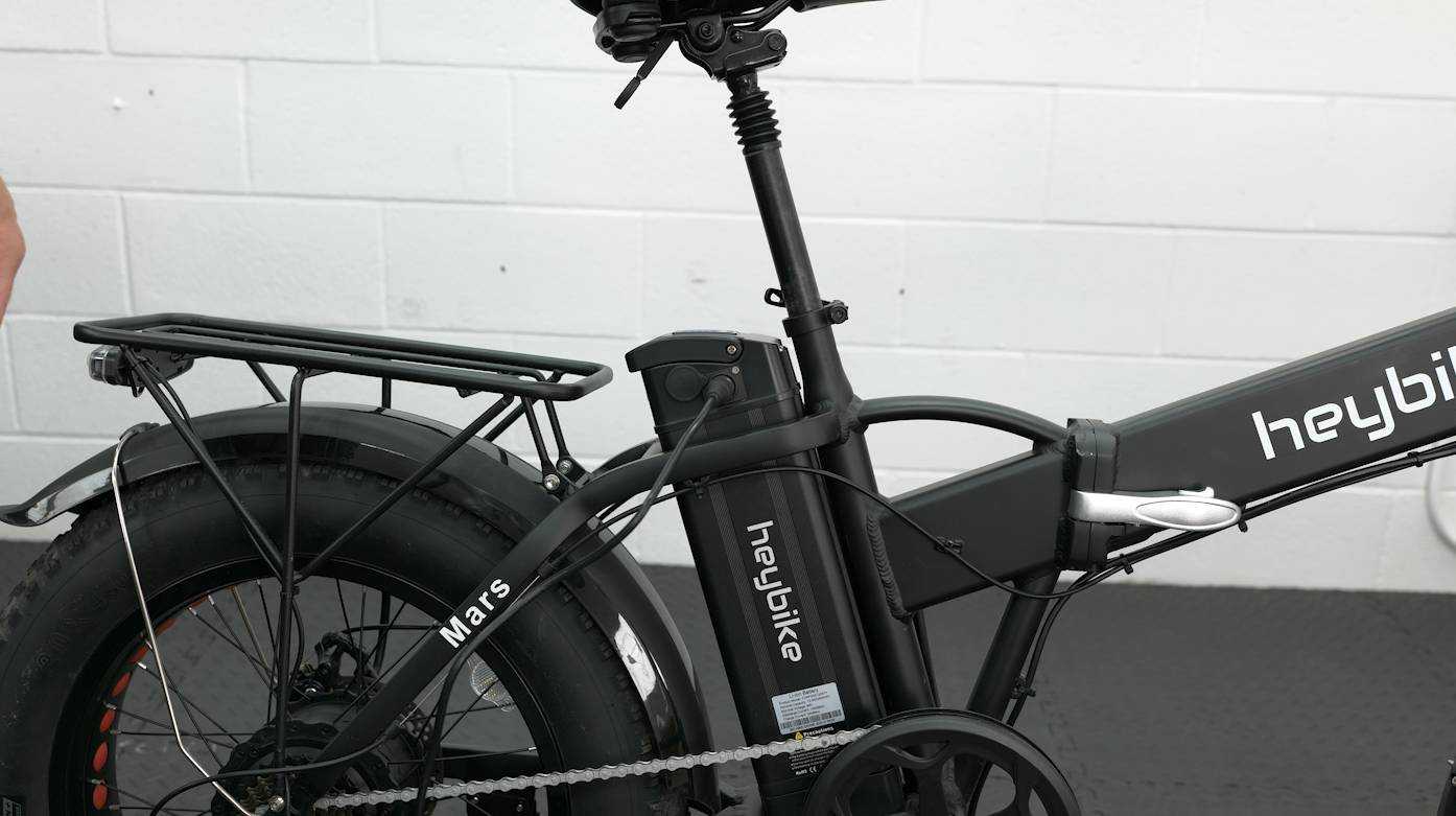

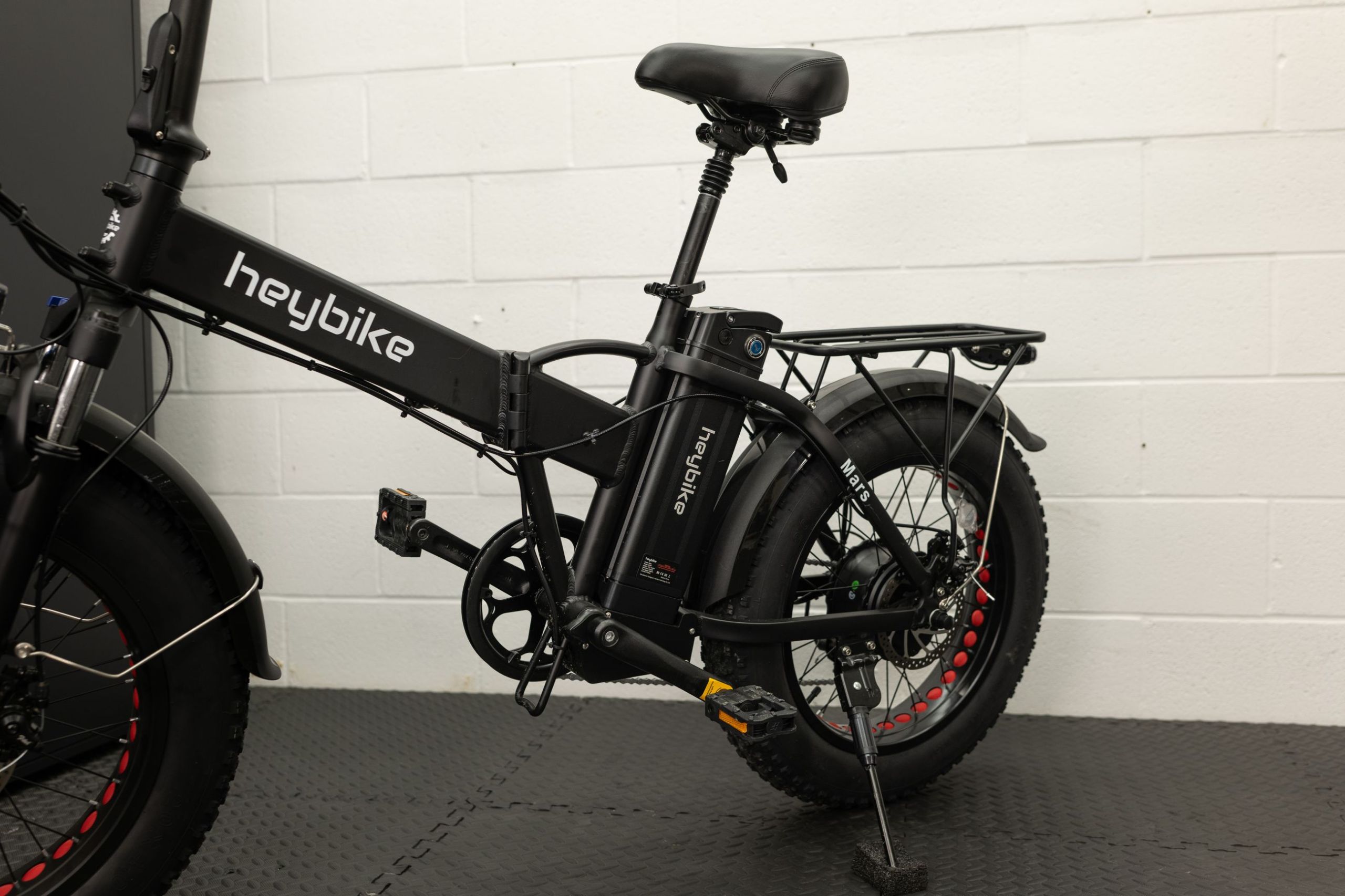

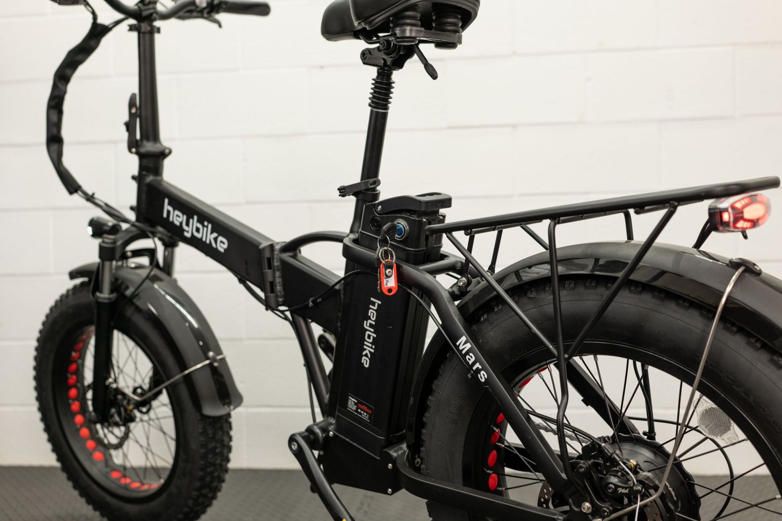

Rear Rack and Battery Placement
The Mars comes with a rear rack with a claimed weight capacity of 100lb. Heybike sells various cargo-carrying accessories, such as baskets and bags.
The battery’s position behind the seat makes removal very easy. The seat also flips down to facilitate removal. There’s no need to duck under the bike to insert the key in a difficult-to-reach slot on the underside of the frame, like other folders. The keyhole is easily accessible.
Close up shot of battery on Heybike Mars
The battery also has a USB port for charging devices, but this isn’t convenient to use while riding.

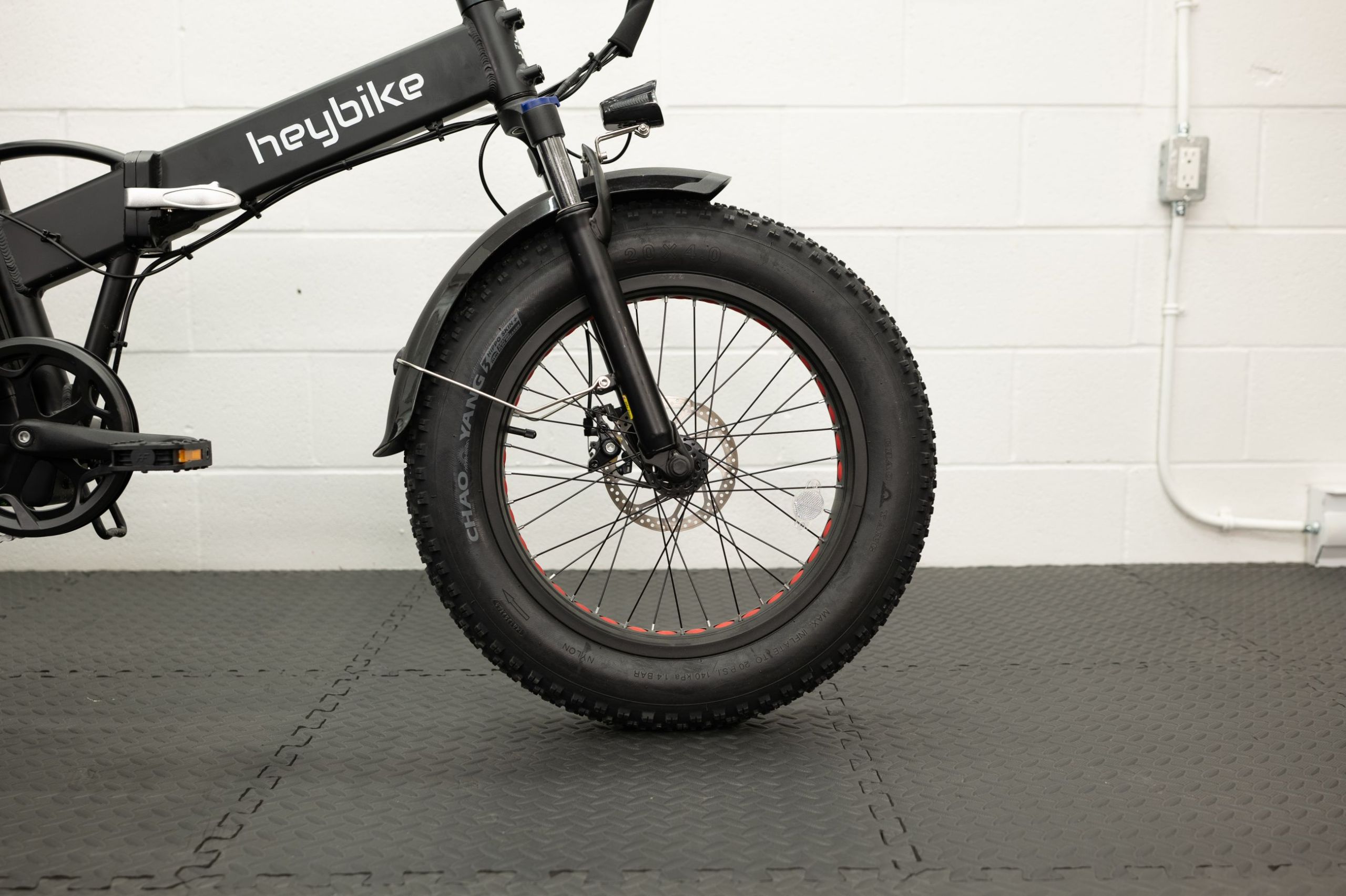

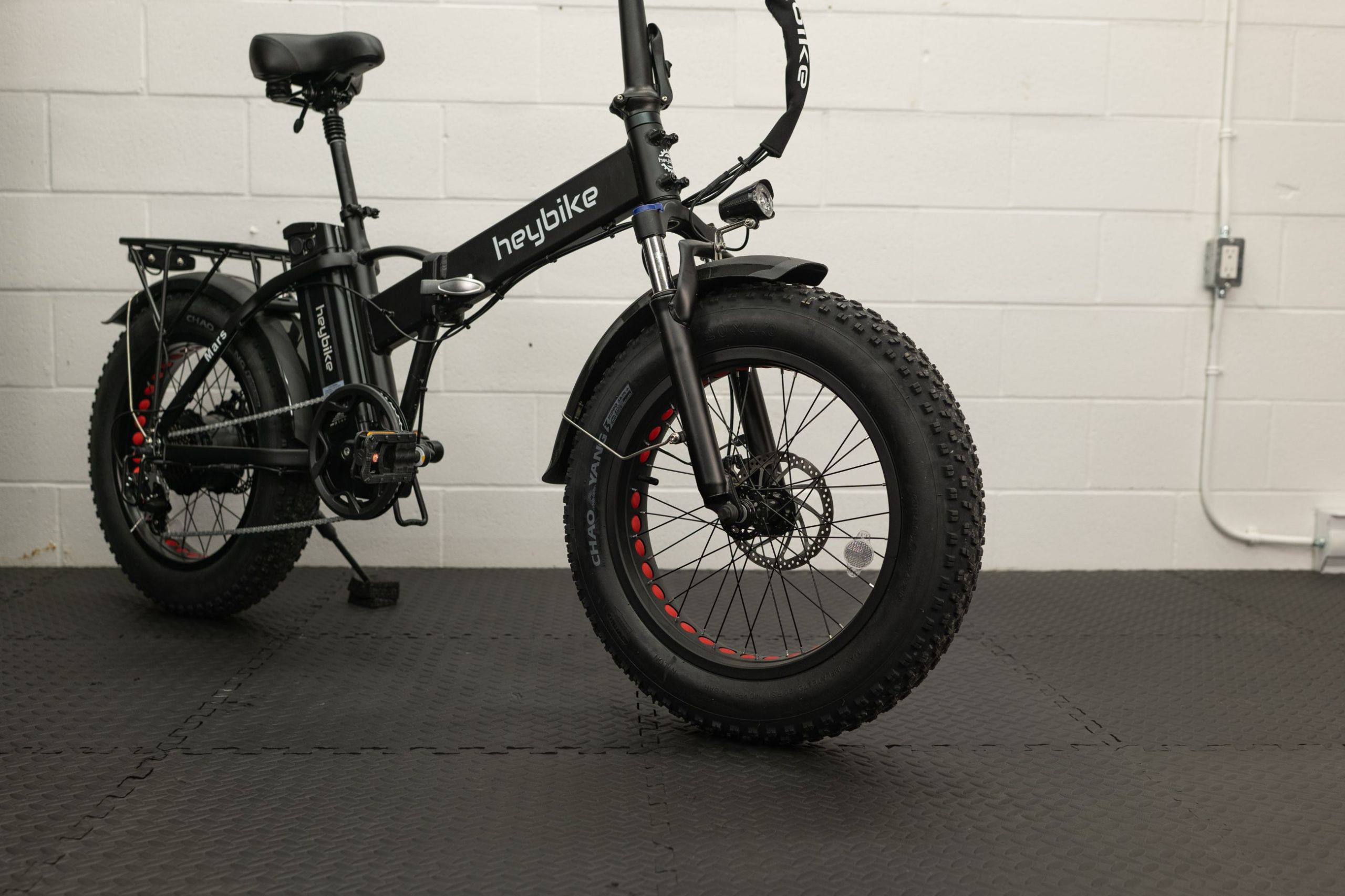

Close up of front wheel Heybike Mars

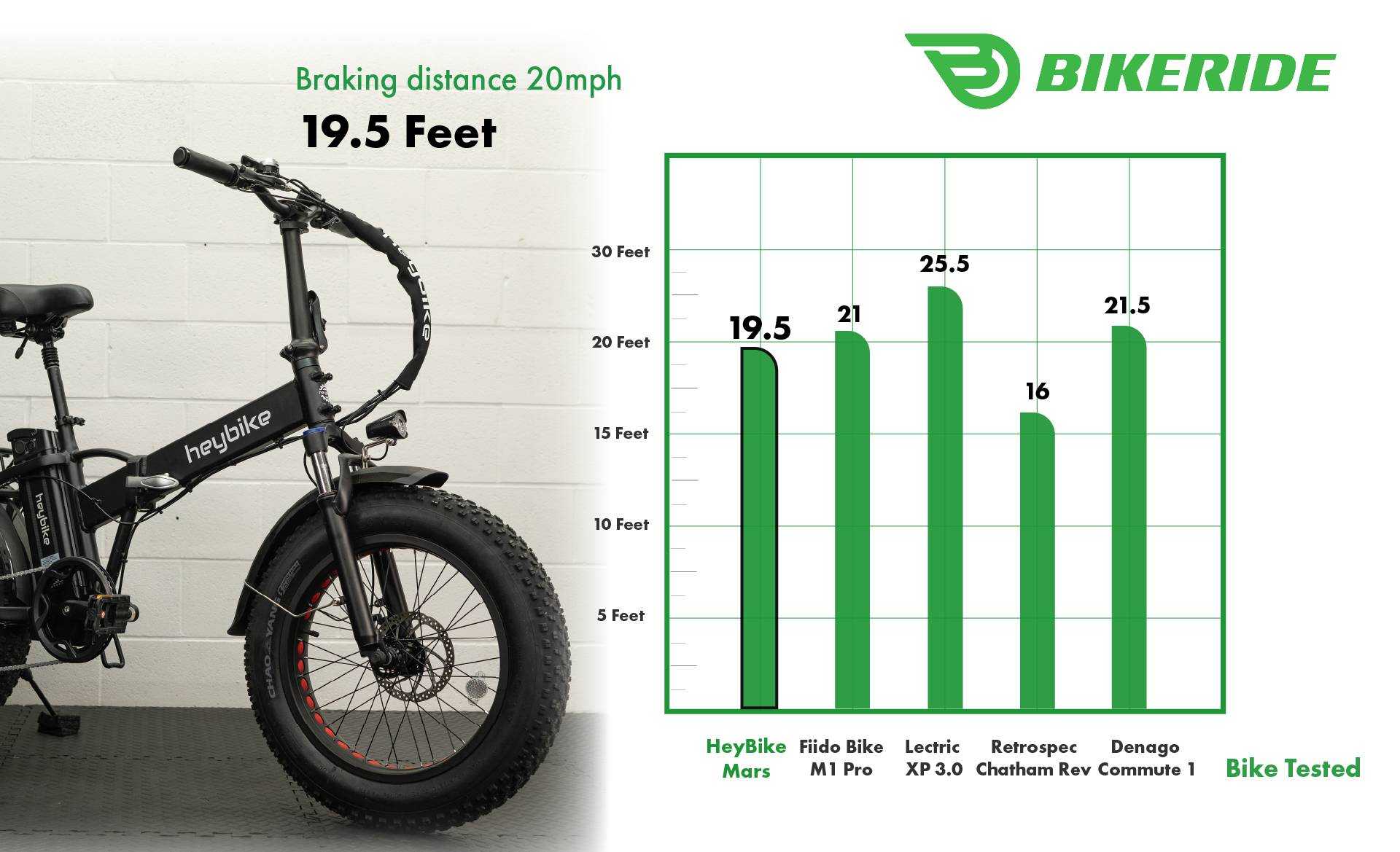

Loud Mechanical Disc Brakes
The included Filel mechanical disc brakes are a particularly low-end component. From the beginning, they were loud, and this got worse as they bed in.
The 160mm rotors are also smaller than average and won’t dissipate heat as effectively as 180mm rotors, which can reduce stopping power on longer descents.

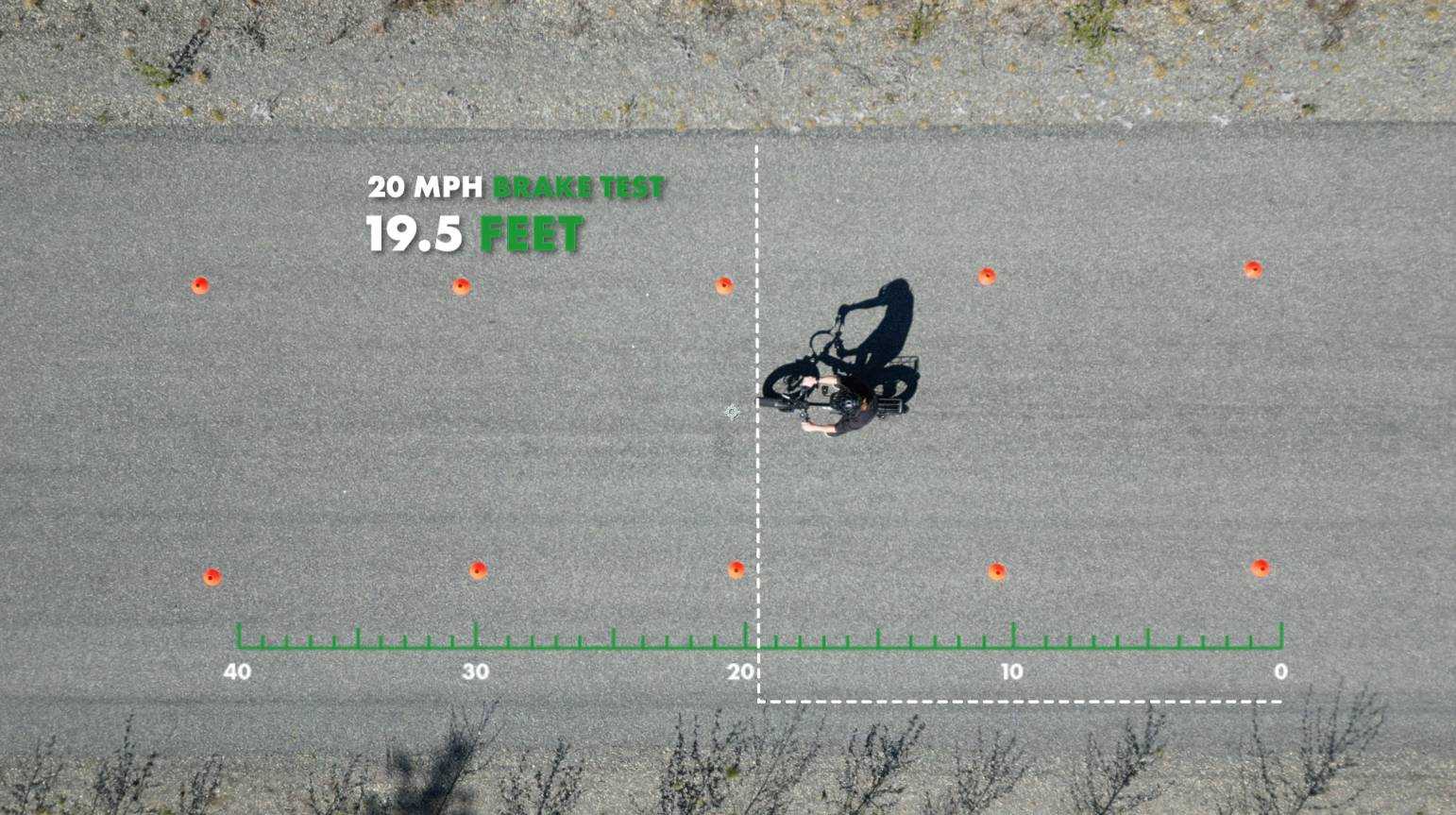

Despite these complaints, the Mars recorded an average stopping distance of 19.5 feet, placing the Heybike Mars in the middle of the pack of the e-bikes we’ve tested.

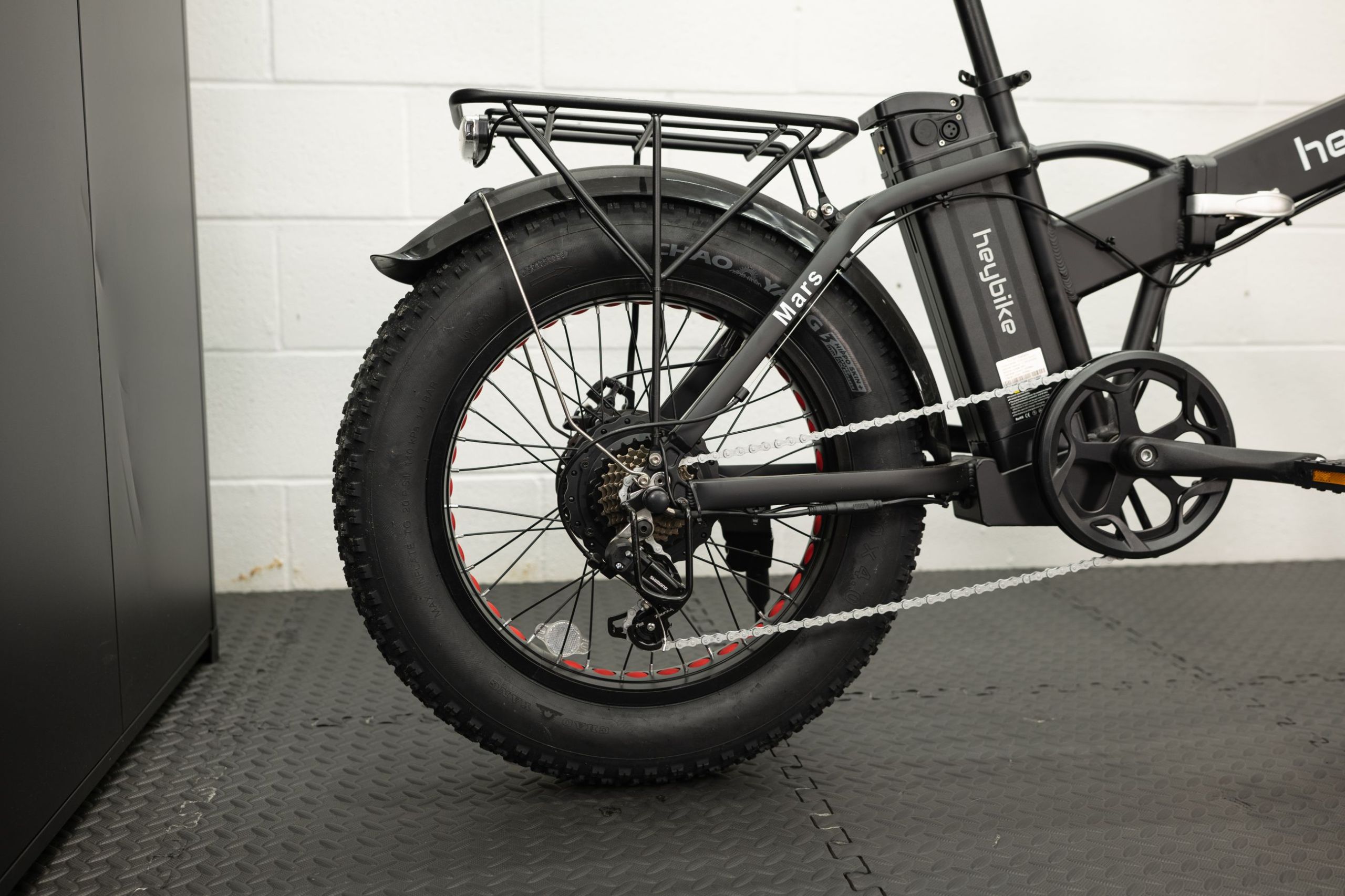

Close up of back wheel and gearing in the studio

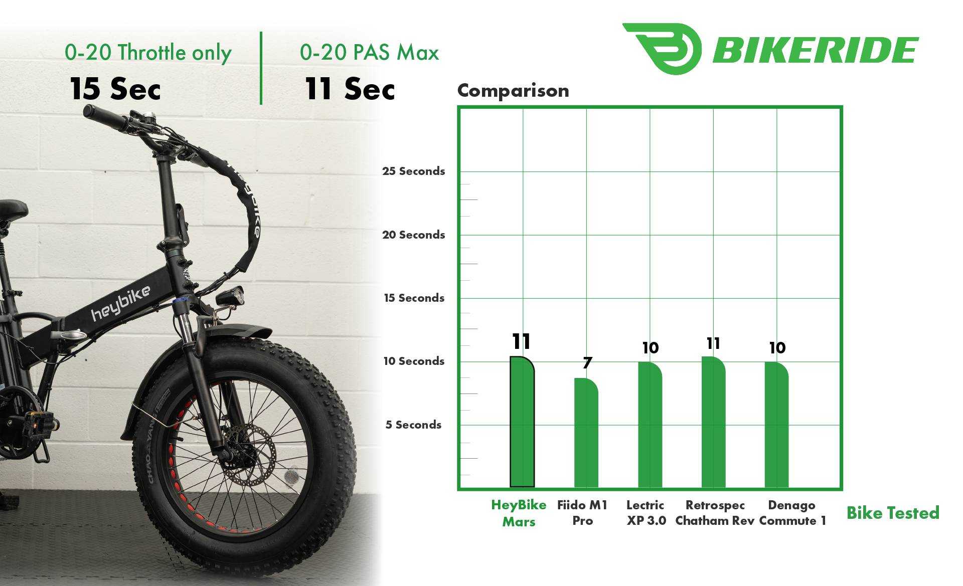

Underpowered 500W Motor
The Mars’ 500W motor is disappointing. The bike feels considerably less capable than other 500W models, with slower acceleration and less potent assistance on steep grades.
It was slower than similar bikes in the 0-20mph and hill-climbing tests. So, if you regularly ride steep hills or want quick acceleration, this won’t be the bike for you.

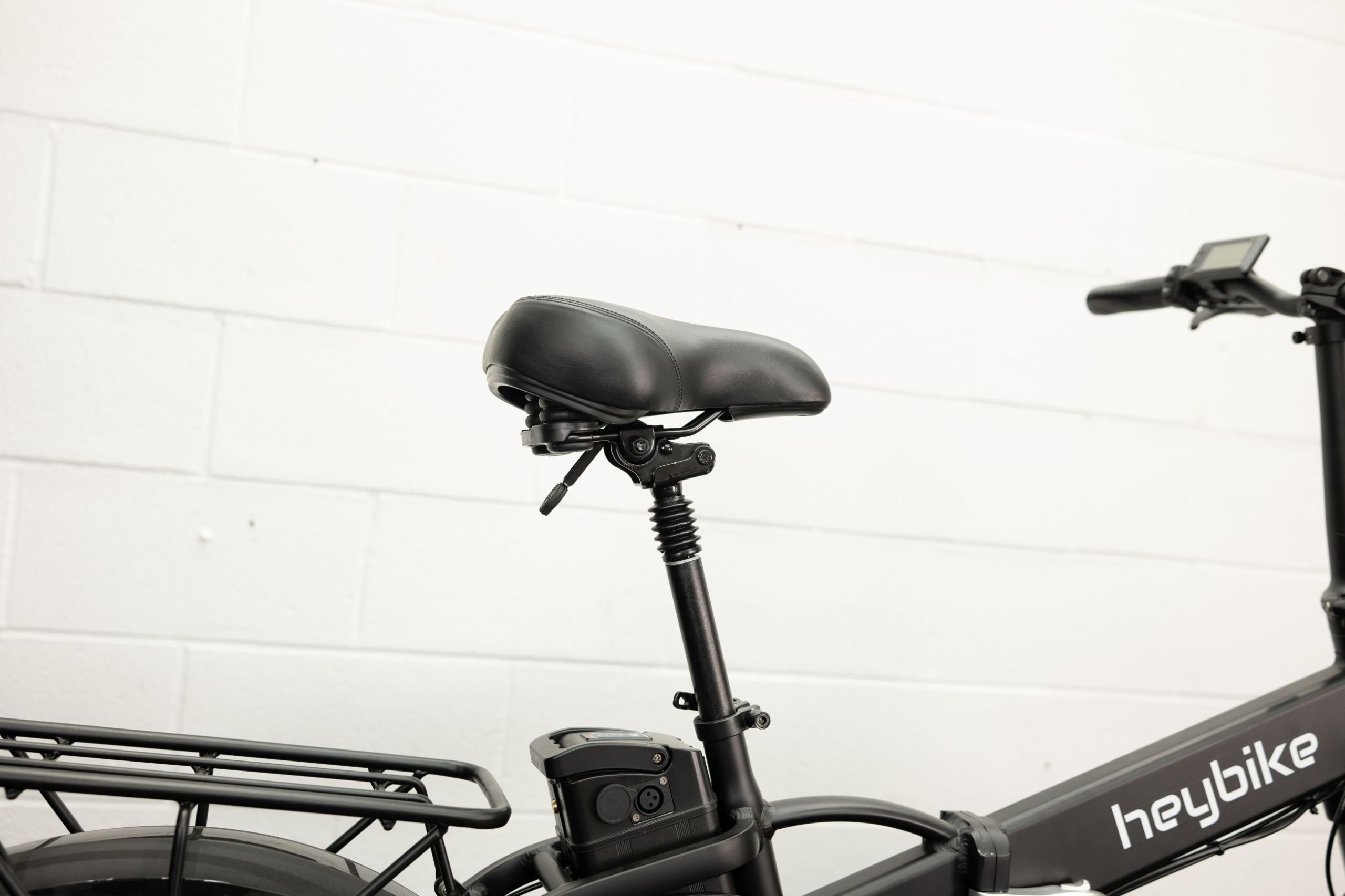

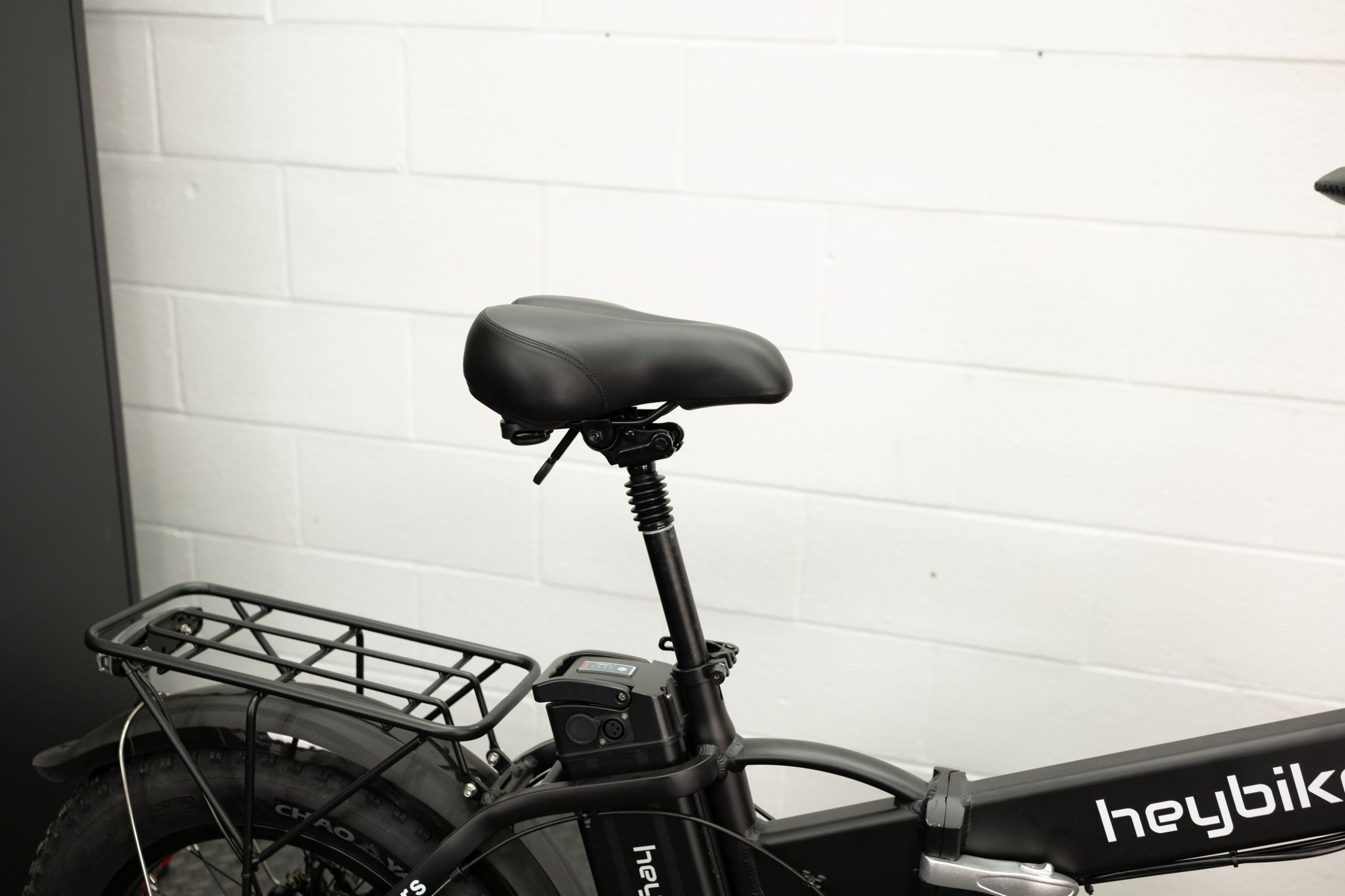

Close up of the seat with dampener and adjustment mechanism
Suspension Seatpost
The Mars comes with a suspension seatpost that offers little added comfort. Just sitting on the seat uses up most of the travel, indicating that the spring isn’t firm enough. Any impacts quickly use up the remaining travel.

What Does It Do Best?
Mars’ defining feature is its ability to fold, which it does well. Though the folded size is still considerable, like most folding e-bikes in this price range, it’s small enough to transport in a vehicle or save space at home.

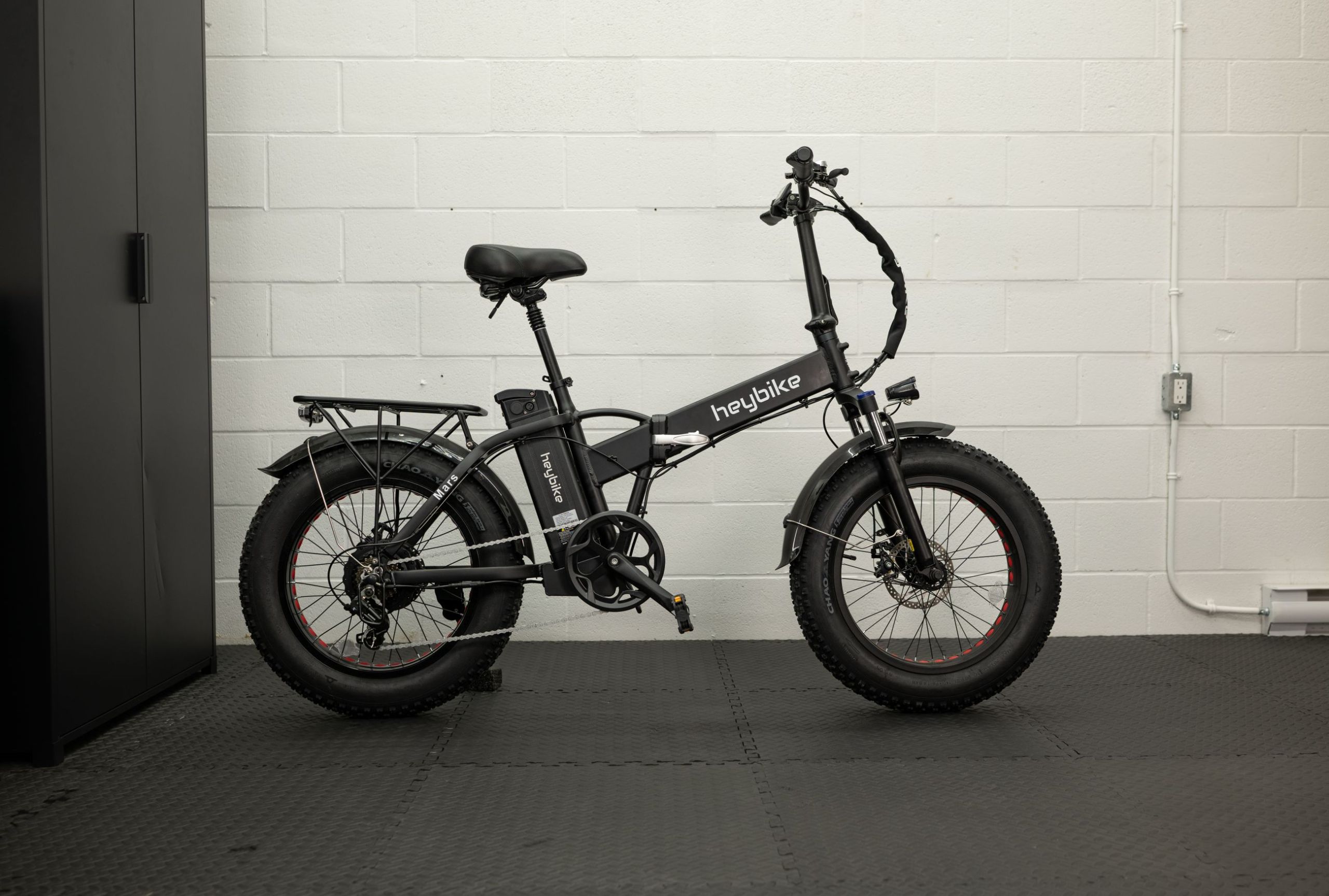

Side shot of Heybike Mars in studio
Frame and Geometry
The Mars frame is less chunky than other folders because the battery is externally mounted on the seat tube. The bike also has a slightly slacker head tube angle than similar bikes we’ve tested, improving how it handles in turns and when riding at high speeds. However, I still felt slightly too far forward.
Another positive of the Mars is that the handlebar height can be quickly adjusted to fine-tune ride position. Finally, Heybike includes a 70mm suspension fork and a suspension seatpost, but the seatpost’s soft spring does little to absorb impacts to the rear.
Seat Tube: 16″ (406mm)
Reach: 19″ (483mm)
Stack: 28″ (711mm)
Stand Over Height: 26″ (660mm)
Virtual Top Tube Length: 23″ (584mm)
Min Saddle Height: 33″ (838mm)
Max Saddle Height: 37.5″ (952mm)
Wheelbase: 45″ ( 1143mm)
Recommended Rider Height: 5’3” – 6’3”

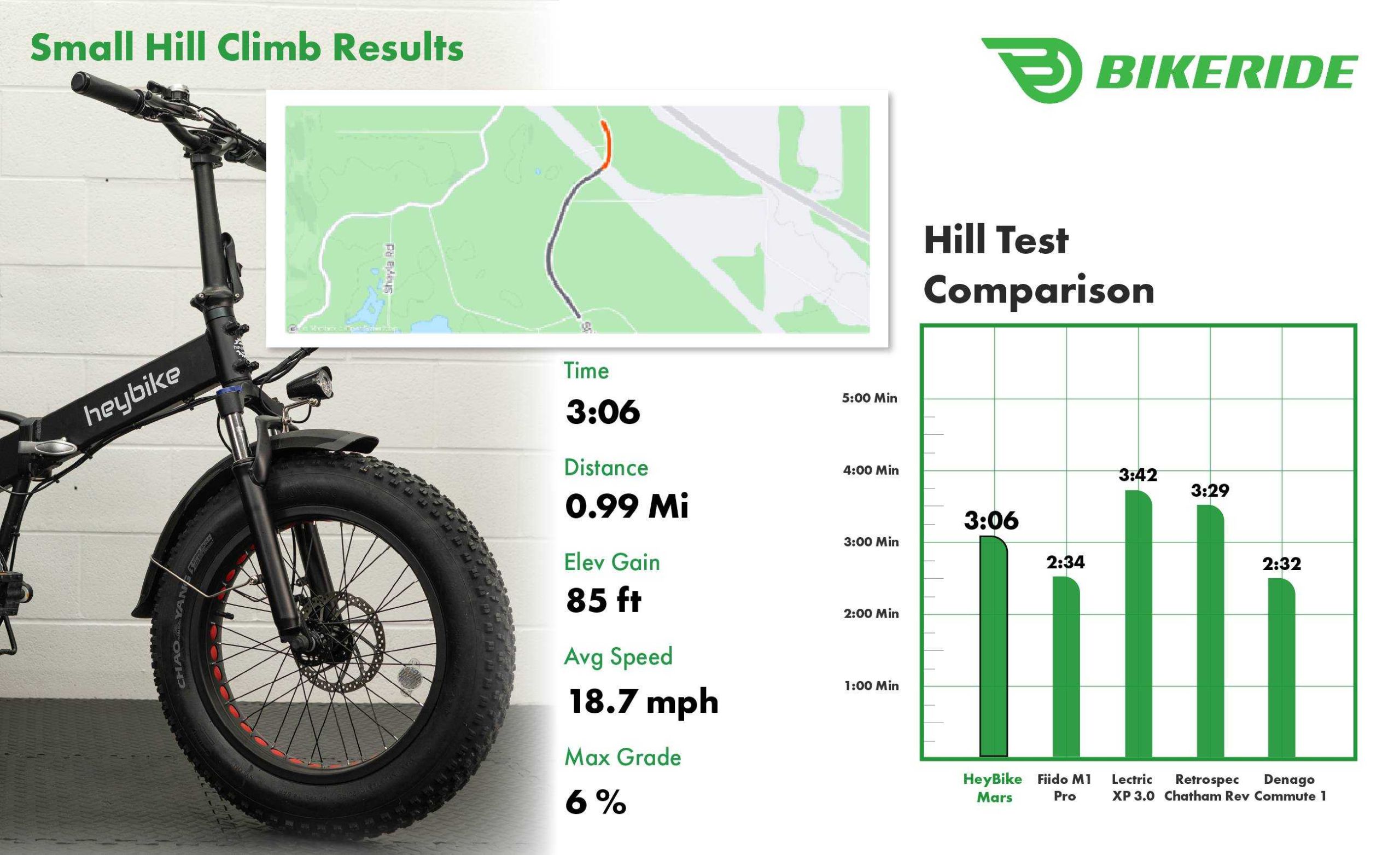

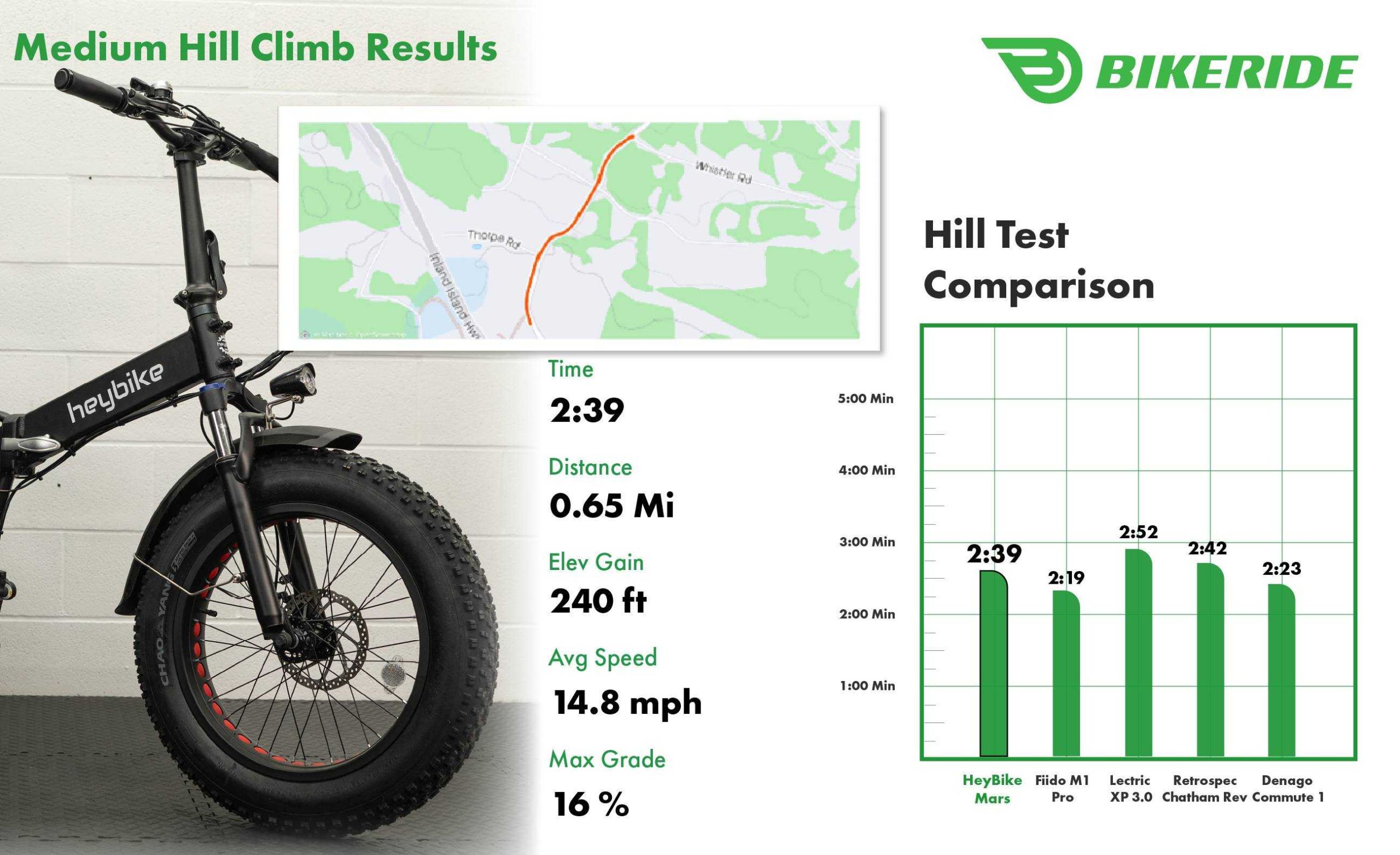

Motor
The Mars uses a Heybike-branded 500W rear hub motor capable of 750W and 50Nm at peak output. The motor is adequate for general riding, but acceleration and hill-climbing performance are underwhelming. As a result, maintaining speed on climbs requires more effort from the rider.
0 - 20kph results for throttle only (15 seconds) and PAS Max (11 seconds)
Small hill climb results with comparison. Heybike Mars scores middle of the comparison
Medium hill climb results with comparison. Heybike Mars scores middle of the table in comparison

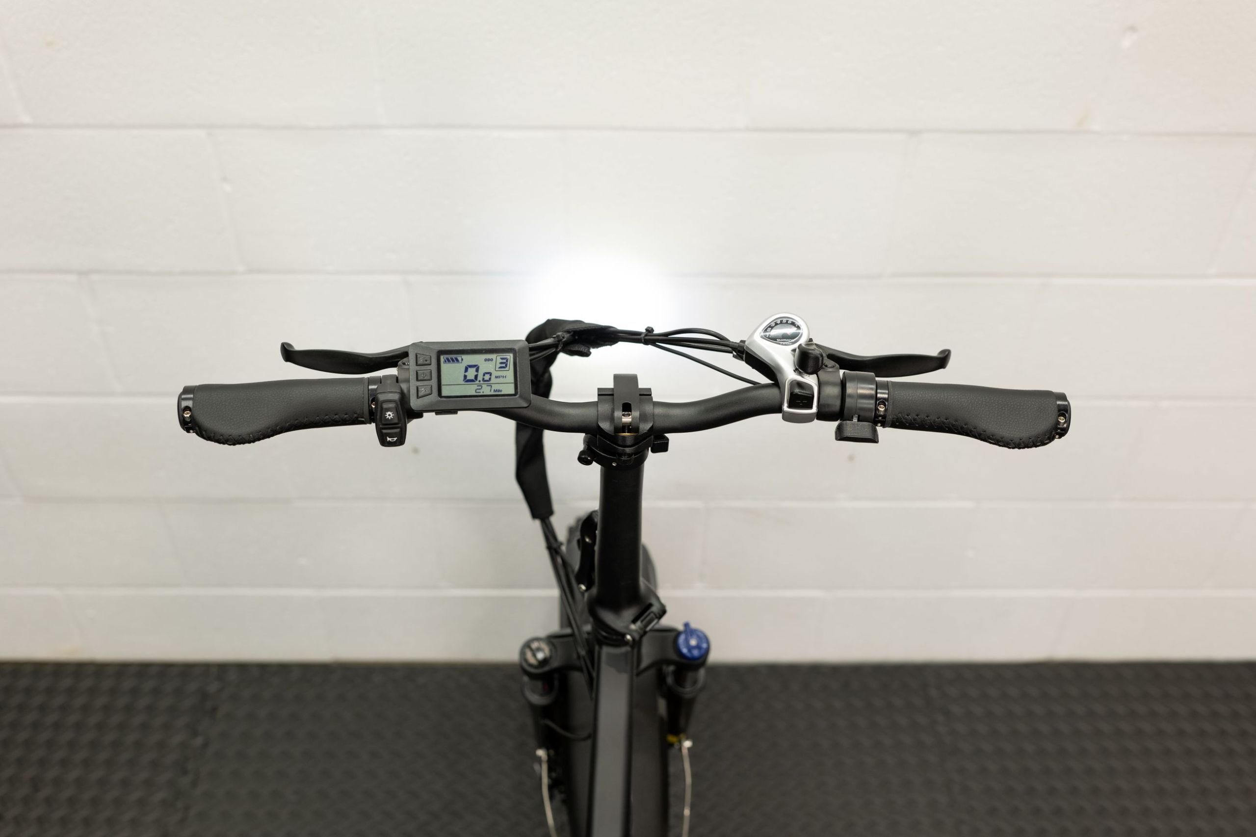

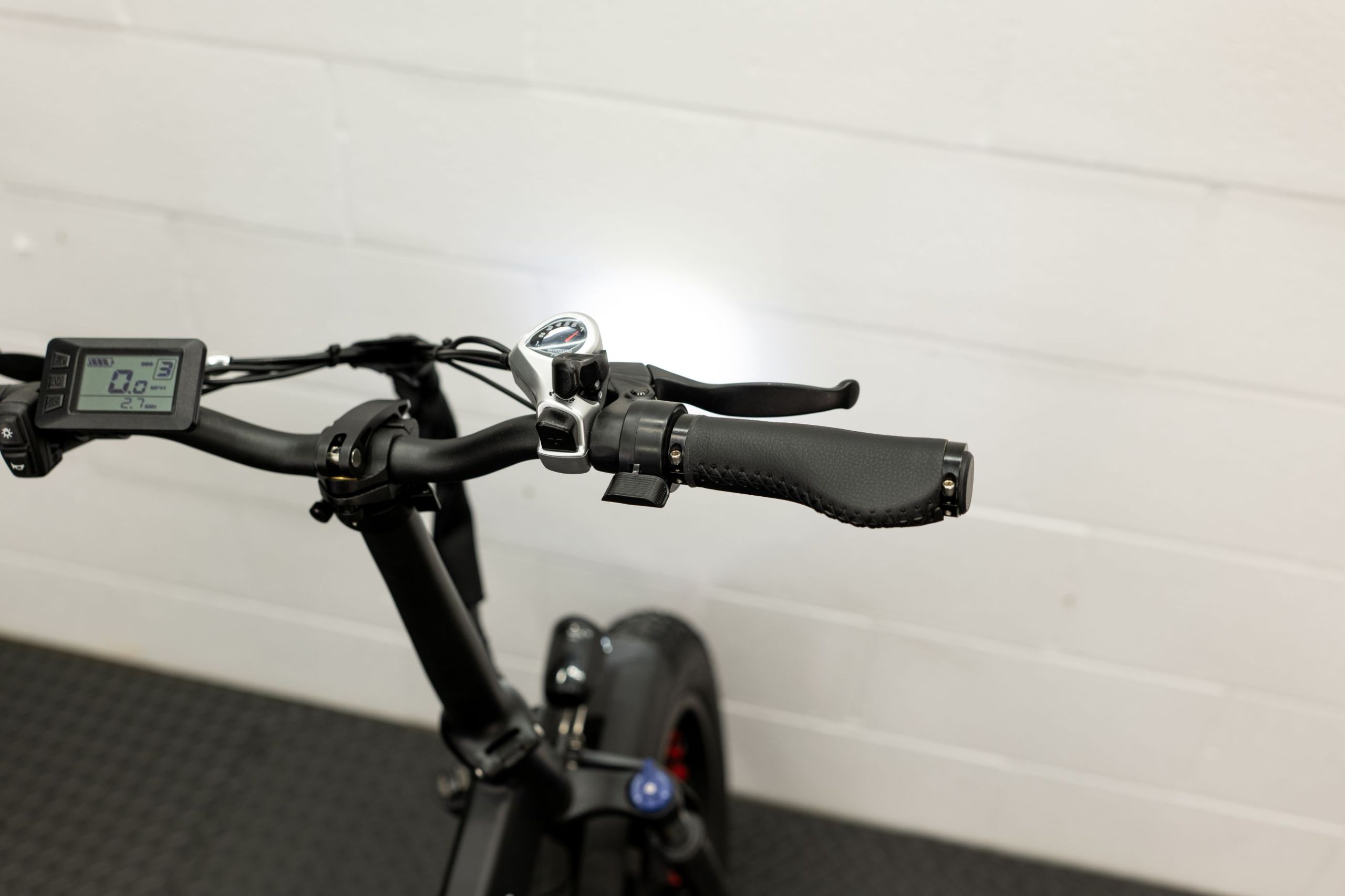

Cockpit and Control
The Mars has 600mm-wide, height-adjustable handlebars with a slight rise. A monochrome display is mounted on the left with an integrated three-button control pad, with separate buttons for the lights and horn.
The display shows typical metrics, including trip and lifetime odometer, speed, real-time wattmeter, and multiple options menus that allow customization of assist levels.
Handle bar shot with light on the studio
The bike also has a thumb-style throttle on the right bar under the TX-50 shifter.

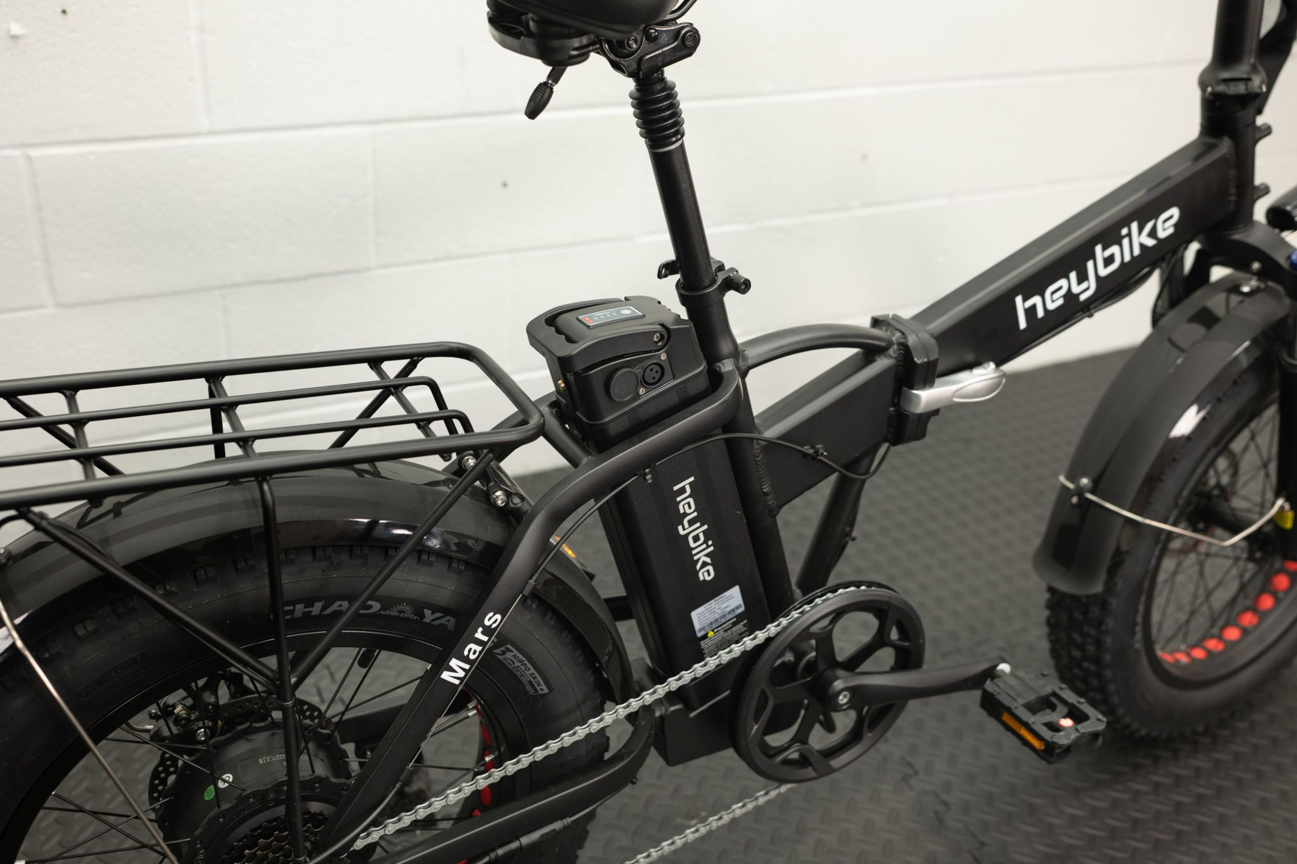

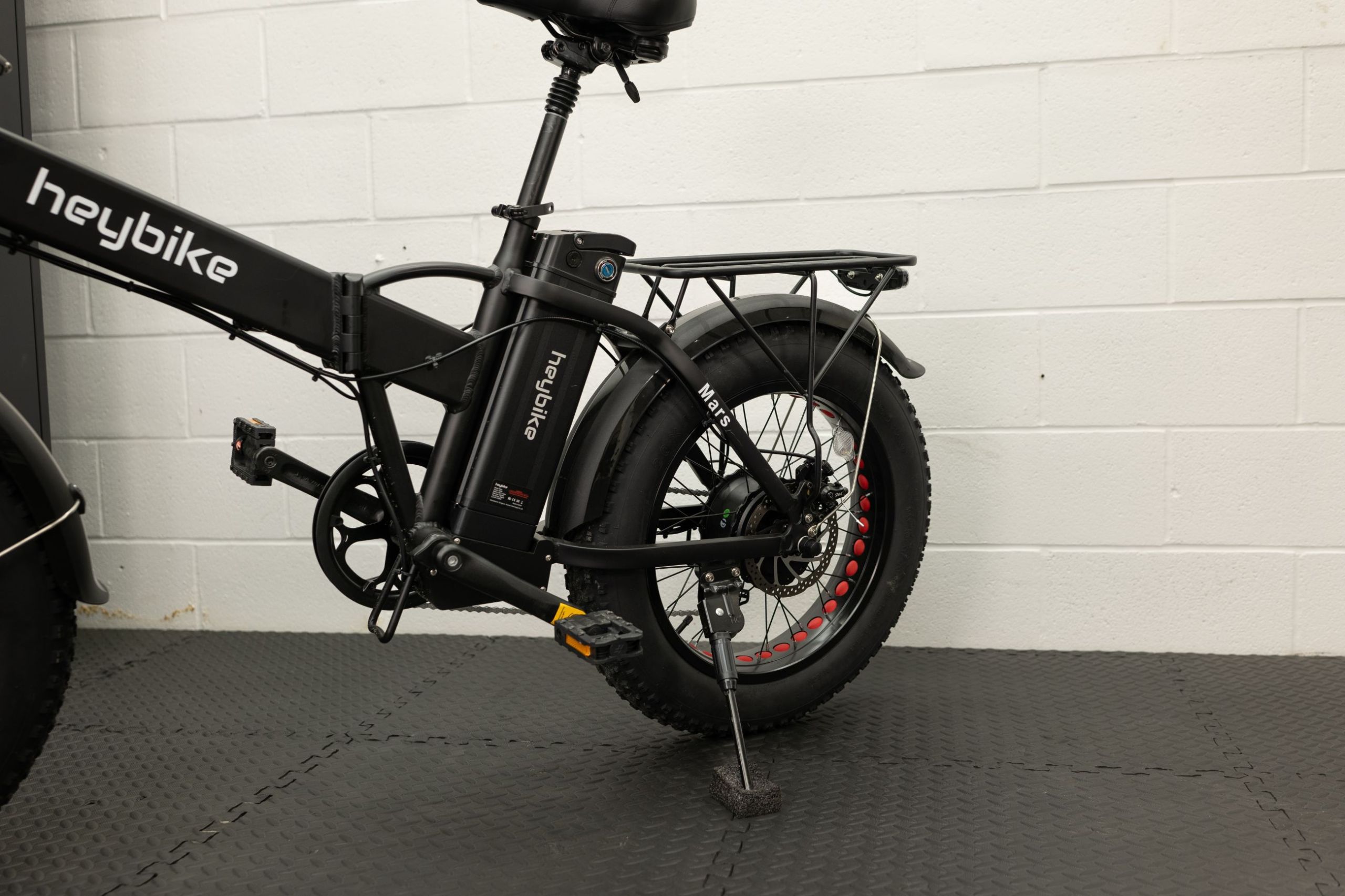

Battery
The Mars has a 48V 12.5Ah battery mounted to the seat tube. The seat flips down for removal. The range provided is impressive, but this means weaker acceleration, as bikes with torque-heavy output have increased battery consumption. The controller also does a good job of tapering the power output as battery voltages decrease, extending range further by reducing assistance and top speed.
Range test results for Heybike Mars. Range comparison table Heybike scores second very close behind first
Battery Removal and Charging
The bike comes with a 54.6V 2A charger that takes roughly seven hours to charge from empty. The charger plugs into a port on the upper portion of the battery, which is easy to see and access. The battery is simple to remove by tilting the seat using the lever under the saddle.

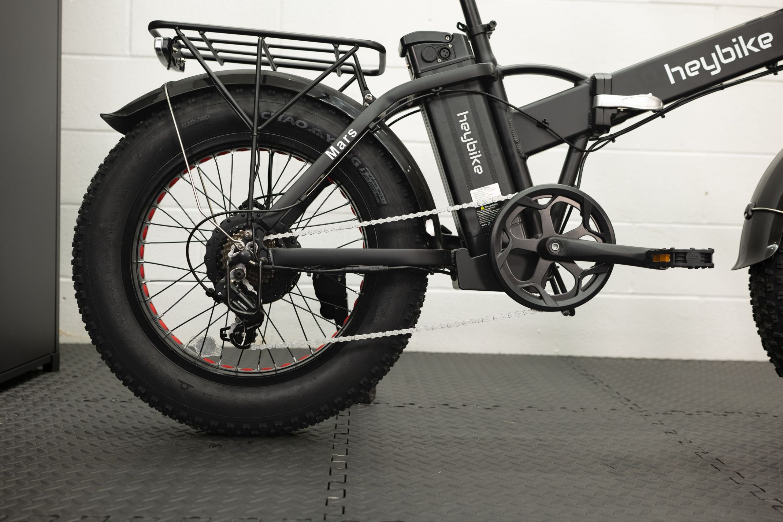

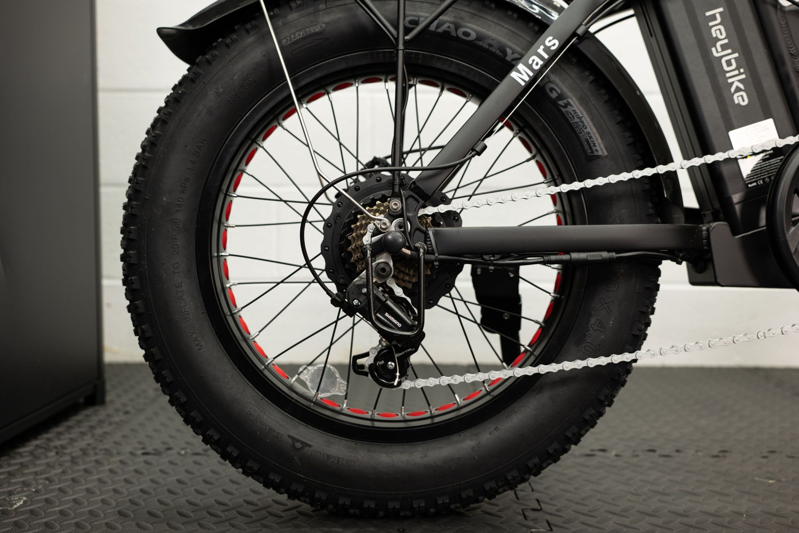

Drivetrain
The Mars has a budget-level Shimano Tourney 7-speed drivetrain with a 14-28t cassette and TX-50 shifter. The chainring has a double-sided aluminum guard. At speeds over 20mph, you will experience ghost pedaling, but this is the motor’s max speed (Class 2), so this isn’t an issue.
The Mars comes with cheap Filel mechanical disc brakes with 160mm rotors and a motor cut-off switch. We would like to see 180mm rotors because they dissipate heat better during extended braking and preserve braking performance. Nonetheless, the average stopping distance was 19.5 feet.
These brakes require lots of a adjustment to ensure they did not rub the rotors, and they generate a lot noise when stopping.

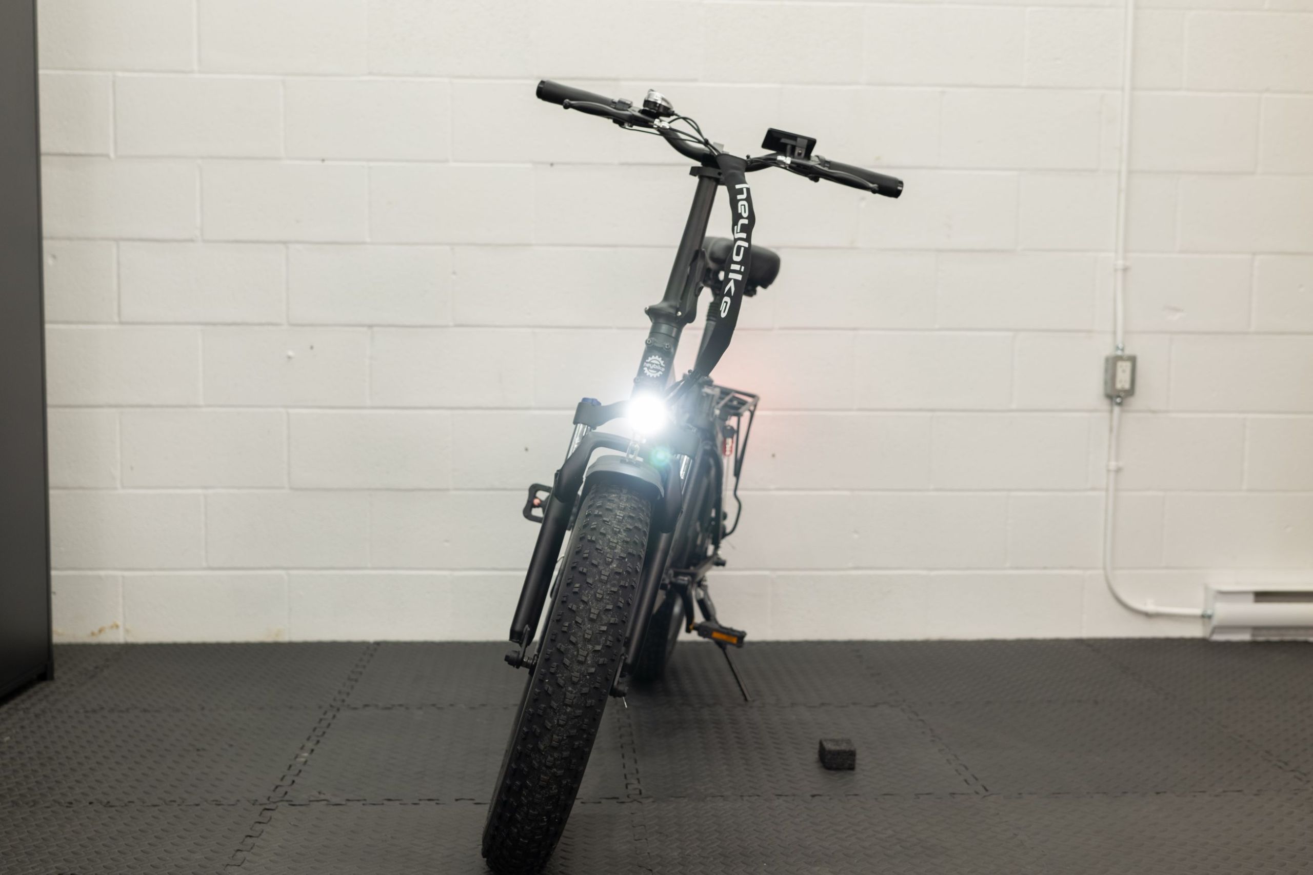

Front of bike with the light on
Safety
The Mars has integrated lights with a dedicated button on the left handlebar. The taillight also includes a brake indicator, a nice feature for city bikes.
The brakes have a motor inhibitor switch to cut motor power when braking and decrease stopping distance.

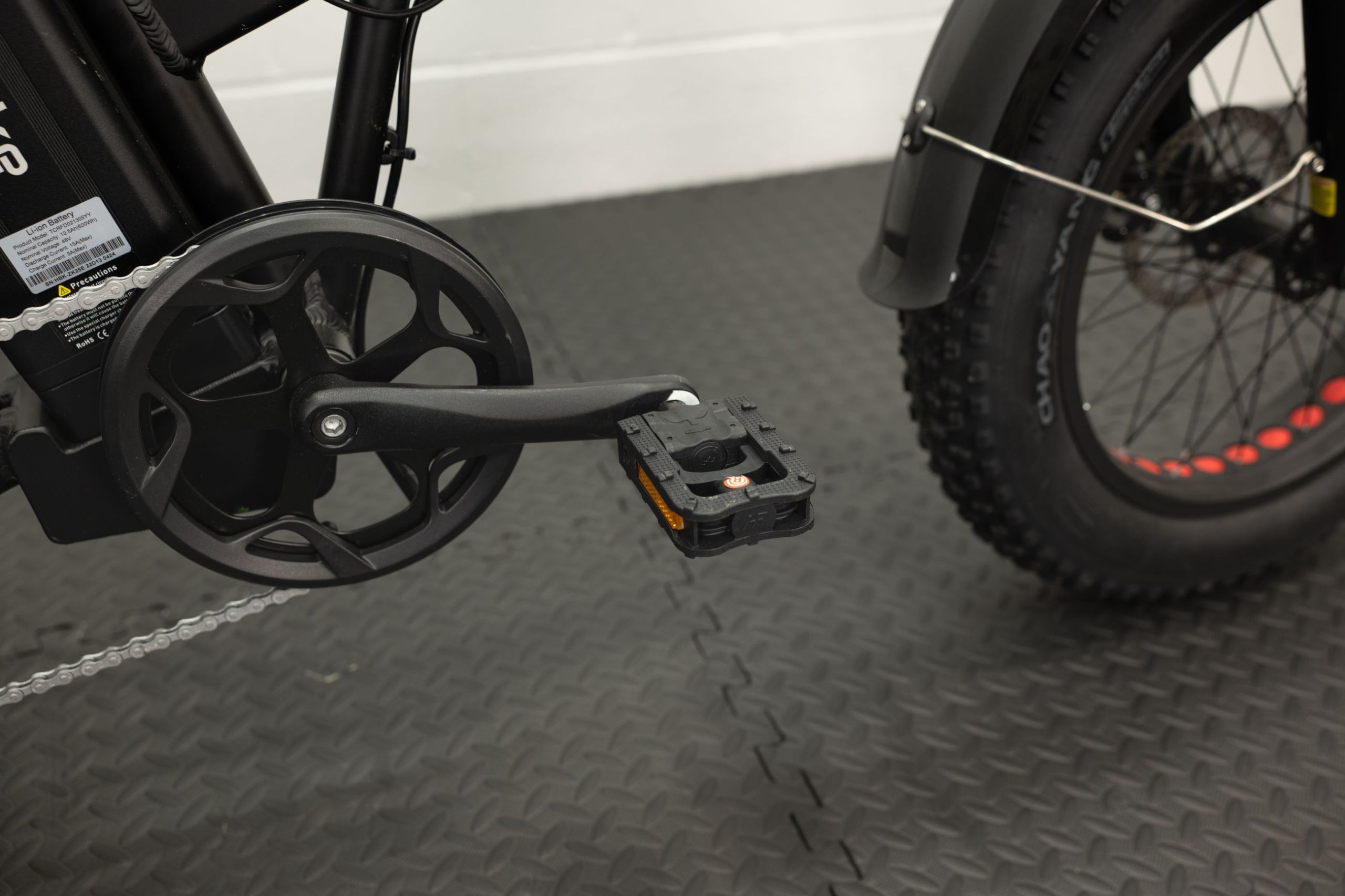

Pedal shot of the Heybike Mars
Pedals
The Mars has a standard set of folding plastic platform pedals. I found them slippery, with only the small pegs for grip.
