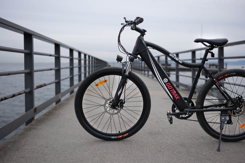

Right out of the box, this bike felt like it was just grabbed off the rack at Walmart. Most people can probably relate to this, as almost everyone has ridden a ‘big box store’ bike sometime in their lives. Built to fit an adult frame, and repping a 350W motor, it definitely promises a little more zip than the unpowered bikes of my youth.
This is a budget-friendly, entry-level e-bike that is both friendly on the wallet and widely available at retailers. Surprisingly, it’s not a wobbly mess and the components seem to work as intended. Is the GOTRAX Emerge an affordable and reliable option for entry-level e-bikers? Could it make it as an economical commuter bike in the city? The price is right, but if the bike can’t make the distance it’s not worth the ride. Let’s put the GOTRAX Emerge through its paces and see if it can pair performance with price.

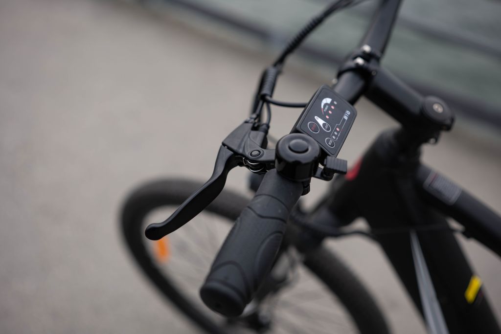

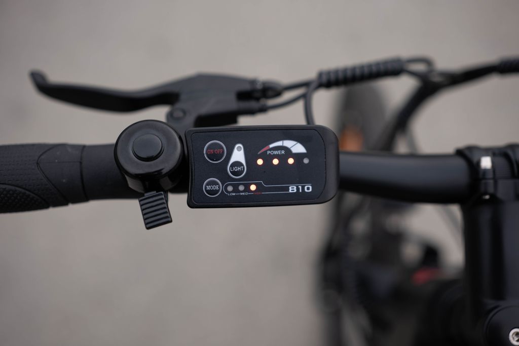

Control Panel
Basic Display
The display is extremely basic. It is not digital and only uses a plastic interface and LED lights to show info. It shows ‘power-on’, three PAS levels, four battery levels, and a light indicator.

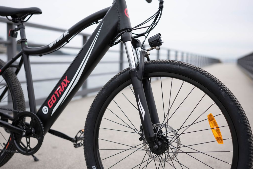

Suspension fork
Suspension Is Low Quality

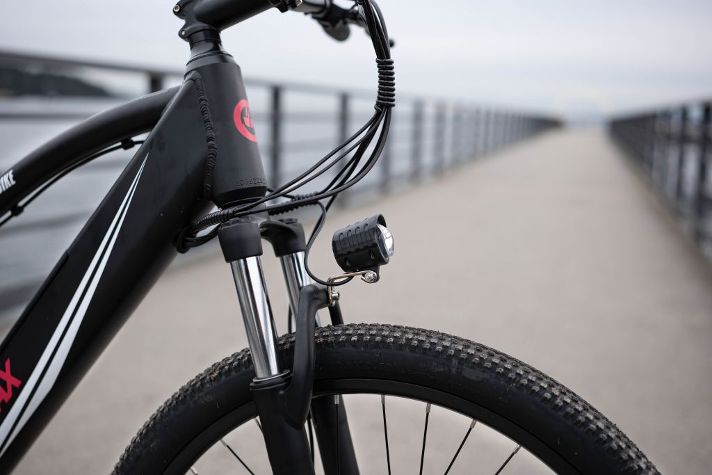

The coil-spring suspension fork is rough and unresponsive. While being better than a solid fork, it’s inexpensive and offers the most basic suspension.
Full Side Shot 3
Low-Cost Components and Accessories
The components and accessories vary in quality. The attached light is quite dim, making it only suitable for driver awareness. The grips are uncomfortable and the shifter feels quite cheap. If you were to go to a ‘big box’ store and grab one of the nicer models off the shelf, it would probably have a similar feel. For an entry-level rider, this may not be an issue. But for those who have experienced higher-quality components, you may be left wanting. Whether or not that is possible at this price point is simply up to opinion.

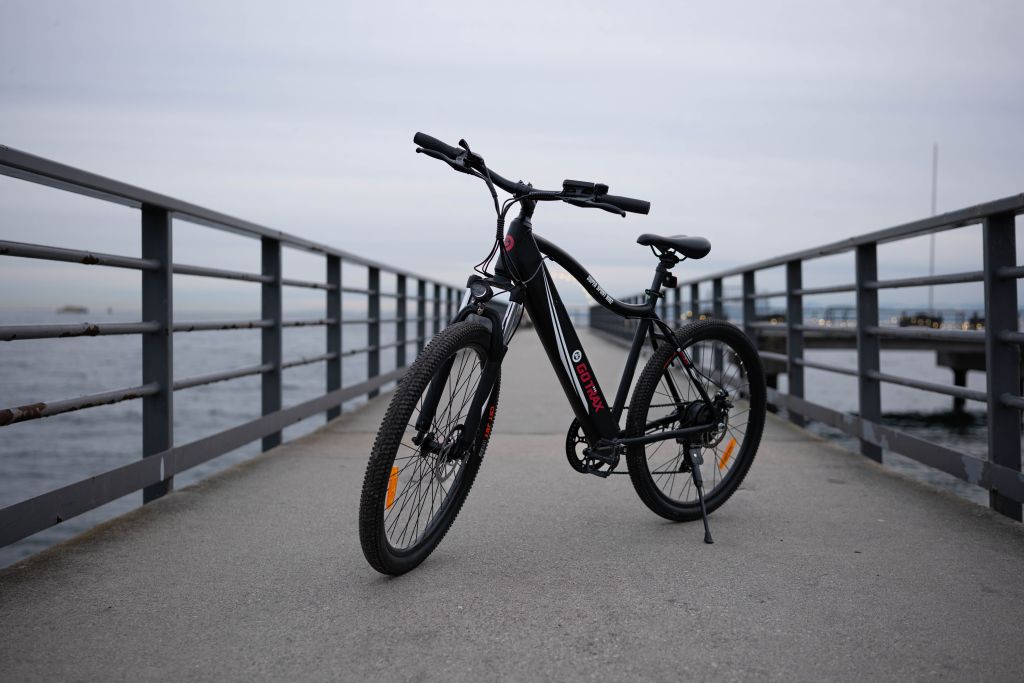

What Is the GOTRAX Emerge?
The Emerge is an entry-level recreational or light commuter bike. It features some ‘mountain bike inspired’ styling, with its front suspension fork and knobby 26” tires. Overall, it features recognizable geometry and offers a relatively comfortable ride. But as mentioned, it feels very much like a ‘big box’ store bike – not overly impressive but decent quality for the price. This bike is firmly recreational and does not offer much for dedicated commuters or advanced riders. Additionally, it’s not a platform to later build-up or upgrade.

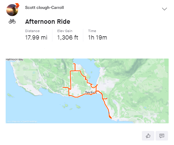

Climb Distance: 0.18 Mile
Hill-Climb Time: 1 Minute 14 Seconds
Average Speed Hill-Climb: 6 Miles Per Hour
Hill-Climb Elevation Gain: 95 Feet
Range Test Data
Battery Range: 18 Miles – Tested (High Assist & Throttle)

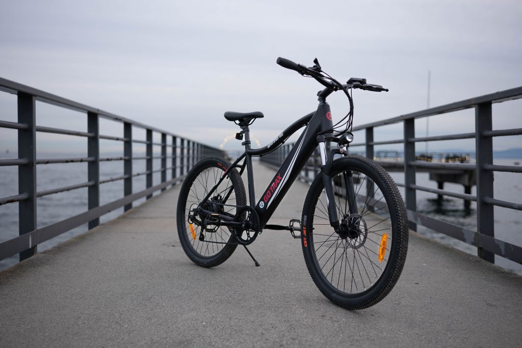

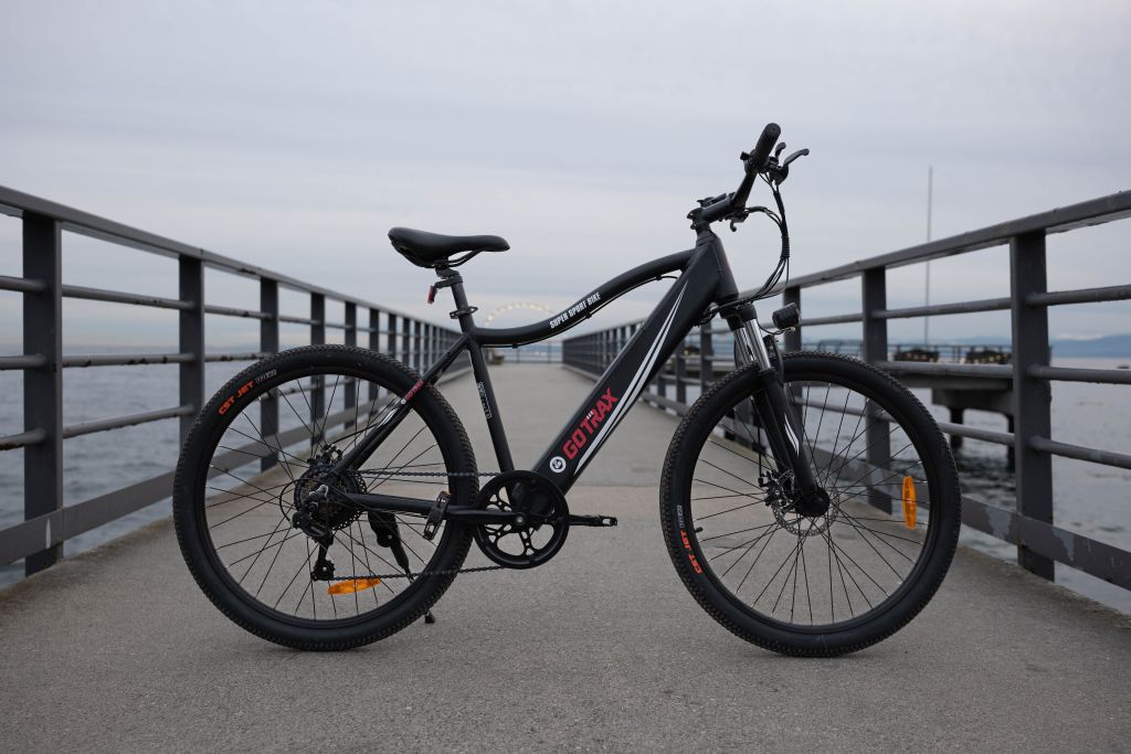

Frame and Geometry
The bike has a fairly classic geometry that many users will feel familiar with. The front suspension fork provides minor cushioning. Overall, the bike is nothing spectacular. It just feels like a bike. It is comfortable to pedal and has an adjustable seat. The longer front stem does cause the steering to feel a bit wobbly and pulls you forward over the bars. It’s a park cruiser and recreational ride, best suited to gentle terrain. The frame is robust enough to stand some abuse. It performs fine on a variety of surfaces. It’s really meant for fun rides on paved footpaths and gentle trails.

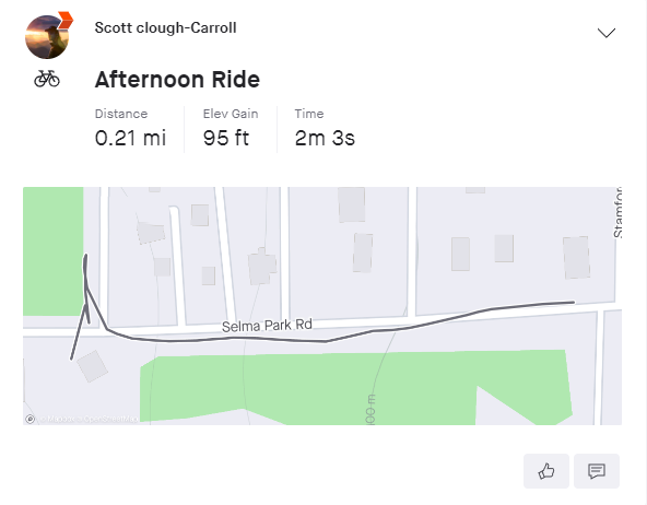

The motor is not a great climber, and steep hills are well past its abilities. It climbs at a slow pace and requires good effort from the rider.
On maximum pedal assist in the lowest gear, the motor performed a 0.18-mile hill climb with 95 feet of elevation gain in 1 minute 14 seconds, with an average speed of 6 miles per hour.
We did not bother testing the bike on a long hill climb as it is not powerful enough.

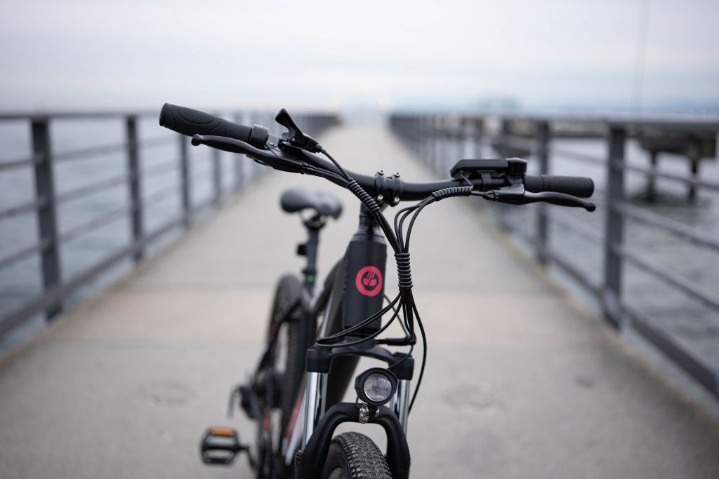

Grip Left
Cockpit and Control Panel
The cockpit is standard and the control panel is sparse. The bars are occupied by the control panel, bell, mechanical brake levers and shifter.
Control Panel
The control panel is very simple. It’s made of plastic with permanent titles, mechanical buttons, and LEDs to illuminate the provided information. It offers a four-LED battery level monitor, light indicator and three pedal assist levels.
When turning, the long 85 mm stem combines with the 26” wheels to leave you feeling a little unstable. I found the bike pulled my weight forward and over the handlebars, causing the effect to be multiplied. Overall, the bike felt very similar to the ‘big box’ bikes I remember riding in my youth.

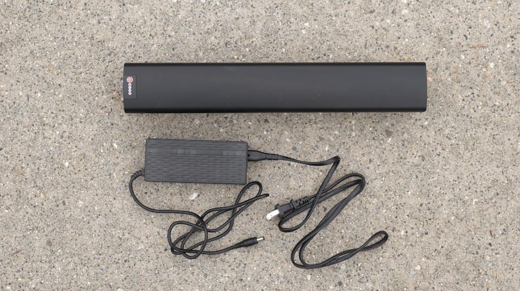

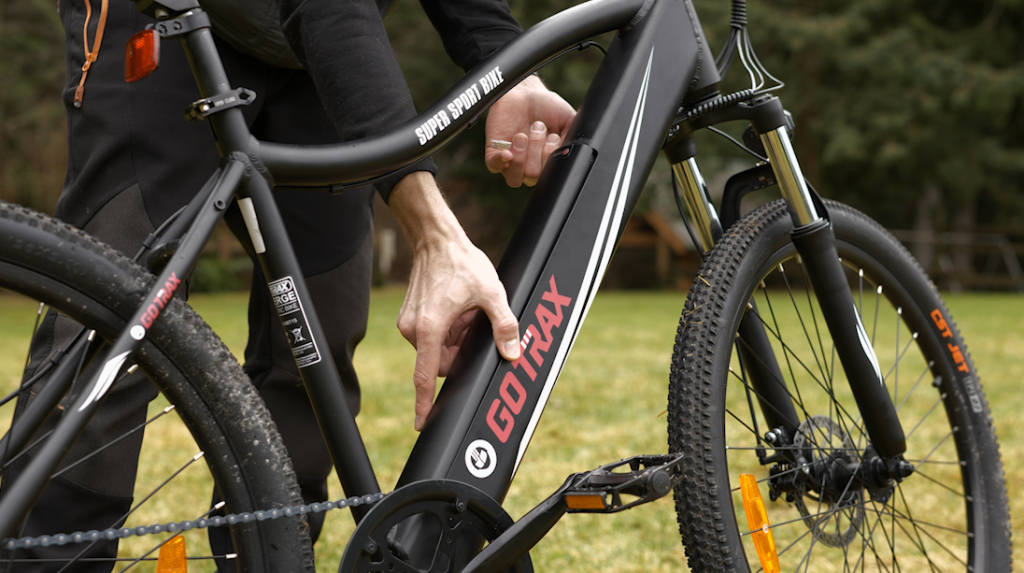

Battery & Charger
Battery
The battery is a 36V 7.5Ah Lithium-ion Battery. It’s integrated into the frame with a secure locking mechanism. The battery does not have a massive capacity, and at 36V it is a lower voltage than the typical 48V batteries we see. The range is reasonable for the battery. Given the bike’s firm positioning as an entry-level e-bike, it is sufficient for the types of riding it will see.
Battery Removal
The battery comes with a standard 2-amp charger.
The key slides into the frame at an upper location that is easy to find and access. The battery locks with a secure click and pops out when unlocked.

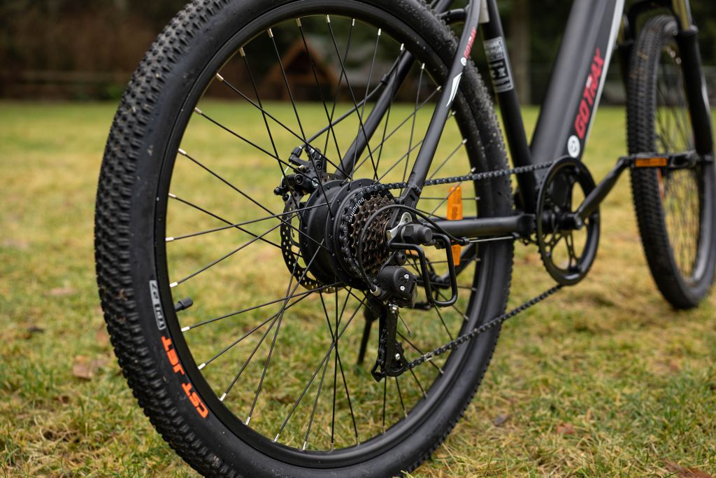

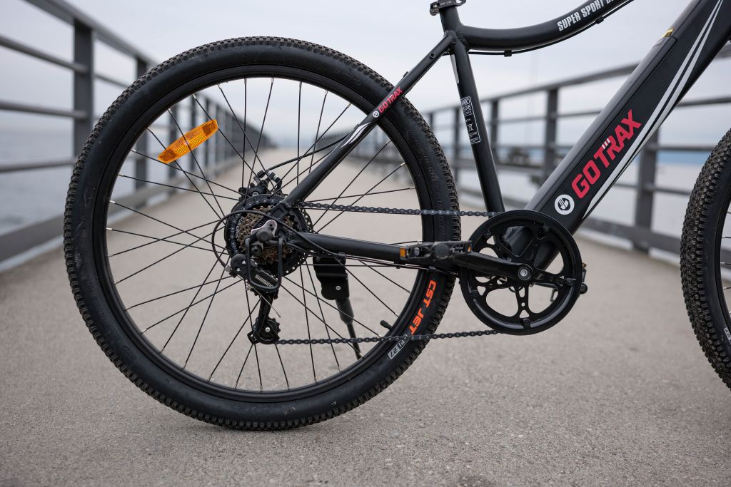

Drivetrain
Drivetrain
The drivetrain features Shimano’s most basic components. It is simple and effective with limited features. The 7-speed drivetrain is sufficient for the bike and easy to use and maintain. It is a firm entry-level item, and the components are typical for what you find on a ‘big box’ store bike.

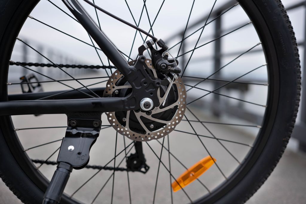

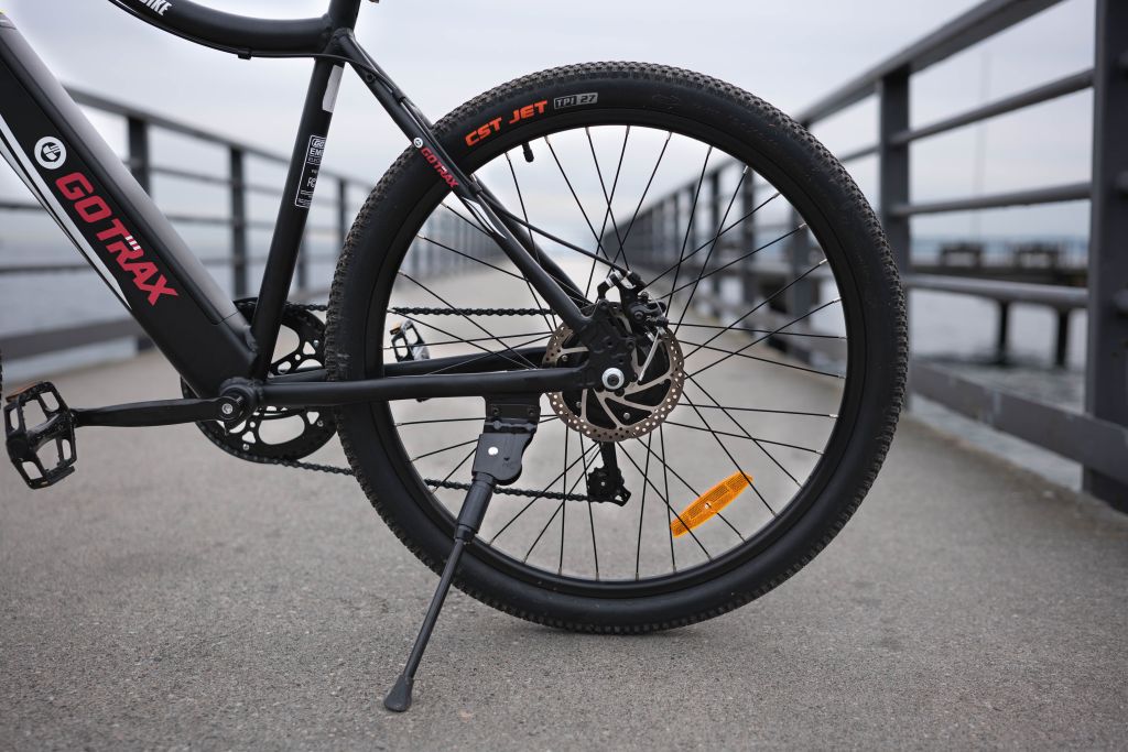

Rear Disk Brake
The brakes are mechanical disc brakes with 160 mm rotors. The performance is fine on flat ground but on steep hills brake-fade is noticeable sooner than expected. The braking performance continues to degrade, the longer and steeper the hill is. Overall, the brakes will be fine for recreational users but leave much to be desired, compared to more performance-minded options.
Rear wheel
Wheels & Tires
The bike rides on 26” rims with 26”×2.1” tires. The tires are a knobby ‘MTB style’, similar to a road tire with extra tread. They provide reasonable traction in dry conditions. However, on wet pavement, sliding when braking is easy to do. The bike is not recommended to be ridden in wet weather, due to the lack of waterproofing and tire quality. On trails, the tires slip in the dirt when going uphill or accelerating. I don’t see them offering much permanence in wet trail conditions and gravel roads – so much so, that I did not attempt it myself.

Kickstand and Rear Tire
Kickstand
The bike features a simple single-sided kickstand. It can come loose and may require some adjustment.

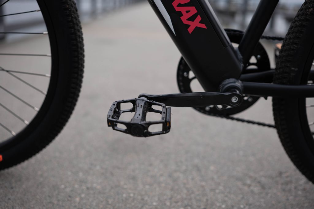

Pedal and Crank
The pedals feature very short pegs. I found them very slippery, especially with wet shoes.

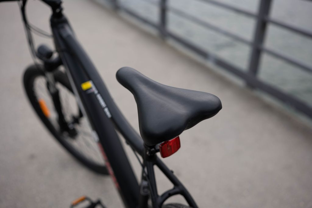

Seat
The unbranded seat is basic and not overly comfortable.
