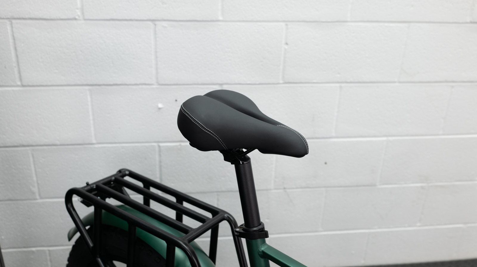

  • Most testers find the saddle uncomfortable.

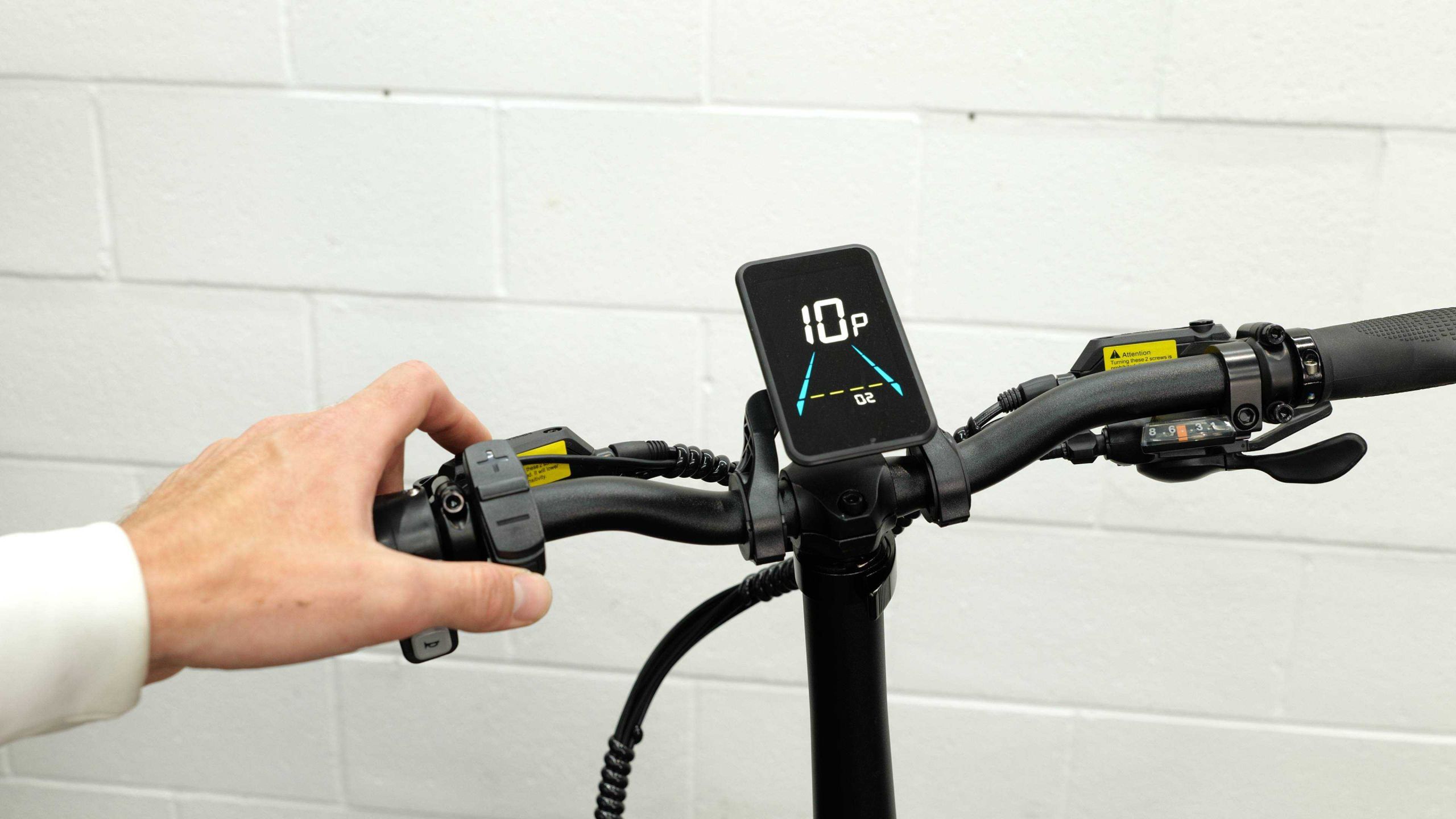

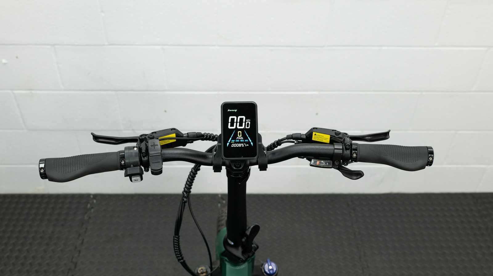

Advanced Menu and Control
The advanced settings menu uses alphanumerical labels with no description of the function. The display manual, which isn’t easy to find online, and the user manual are needed to decipher the menu. The display manual we found was also for the old version of the bike, so not all the information was relevant.

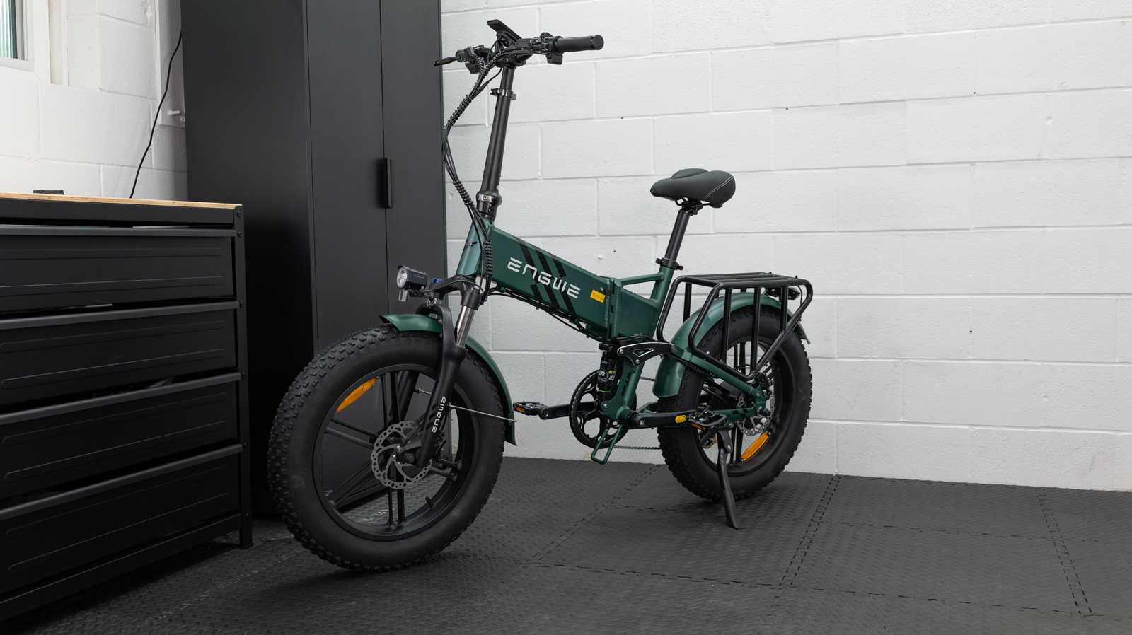

Frame, Fit, and Suspension

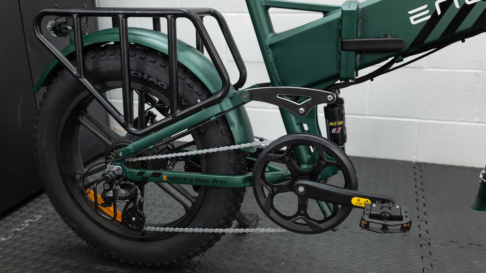

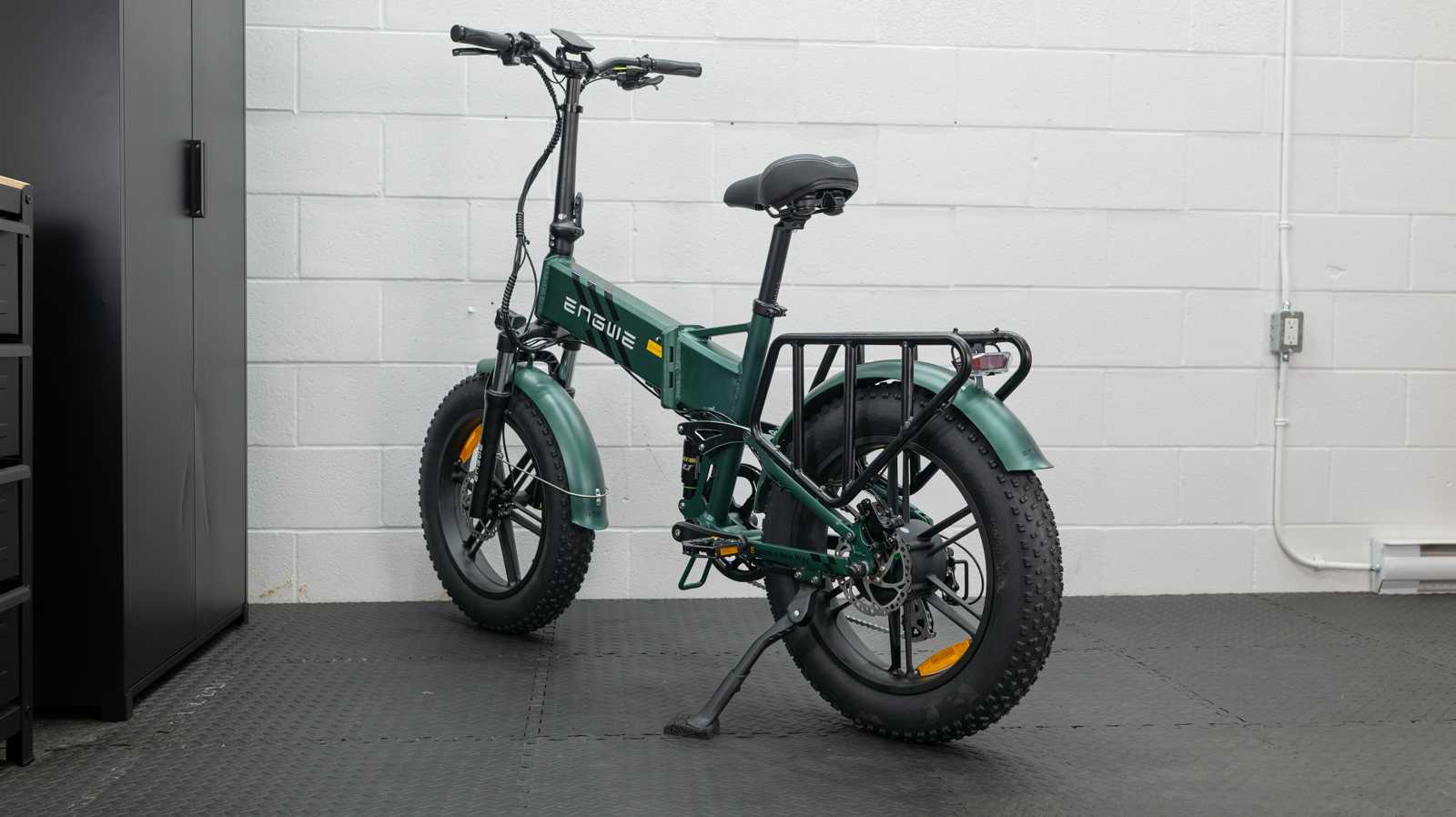

The Engine Pro 2.0’s folding aluminum frame looks typical for the fat-tire folding category, with a bulky single tube and the battery held inside.
The bike folds at the stem, the frame folds in the center, and the pedals fold. Unfortunately, the bike doesn’t have a mechanism to hold it together while folded.
The Engine Pro 2.0 supports a payload of up to 330lb, and the rear rack is rated for 55lb.
Buyers can choose from three colors: Space Black, Midnight Blue, and the Mountain Green. However, the frame is one size, which has a claimed height range of 5’4” to 6’2”. I didn’t need the full seatpost extension, so the max height of 6’2 seems reasonable. The riding position is straight-backed, and the handlebar’s height is adjustable to quickly find the right fit.
The suspension components include a 90mm-travel coil suspension fork with lockout and preload adjustment, and a non-adjustable 30mm rear shock.

The brakes are unbranded 2-piston hydraulic discs with 180mm rotors. The website says the bike has 160mm rotors (another inconsistency), but customer support confirmed that the bike comes with 180mm rotors.
The drivetrain consists of a Shimano Altus derailleur and trigger shifter, an 8-speed 14-28t freewheel, and a 170mm aluminum crankset with a 52t chainring.

Finally, the cockpit has locking rubber grips with an ergonomic flair, a thumb-style throttle, a horn, a 3” color display mounted in portrait, and the trigger shifter. The other touchpoints include a well-padded K-San comfort saddle and folding aluminum pedals. These pedals have small metal pegs, but they’re slippery when wet.

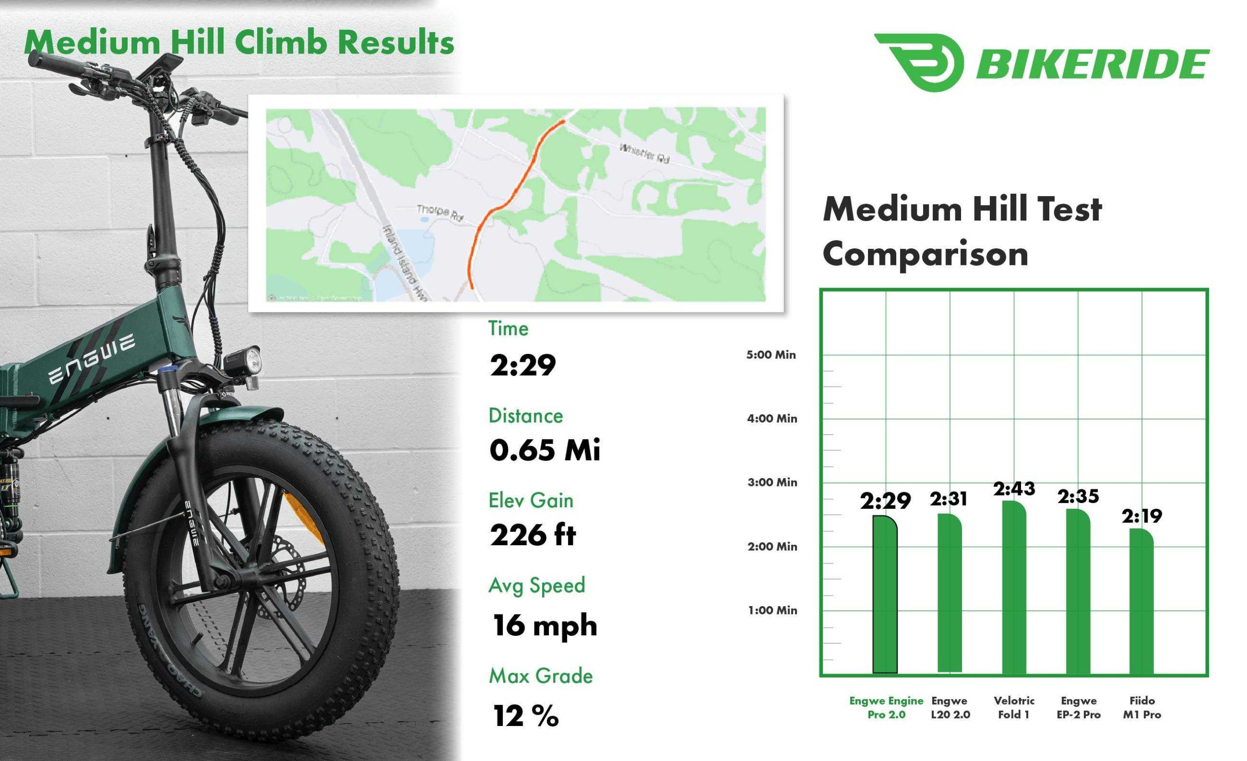

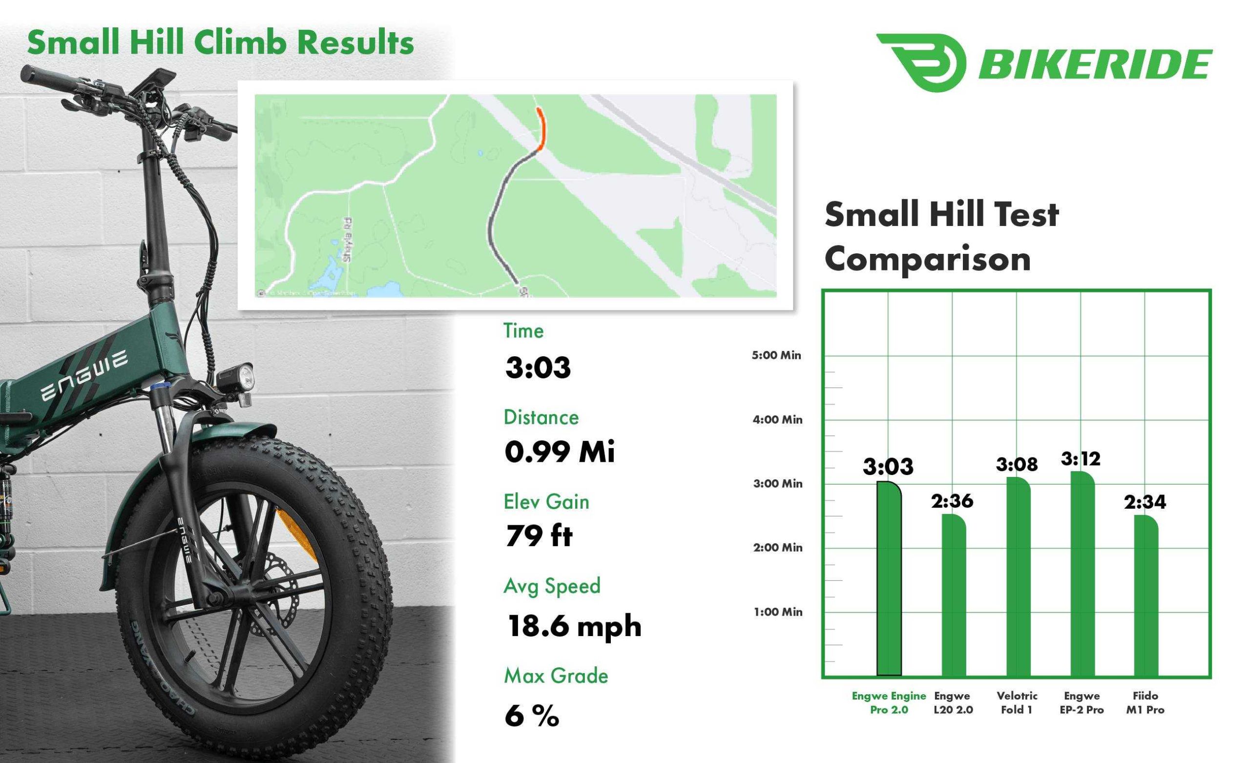

Hill Climb Tests
The Engine Pro 2.0 performed well in both hill tests. It reached the top of the longer, shallower climb in 3:03, which was faster than Velotric’s Fold 1 and ENGWE’s own EP-2 Pro but slower than ENGWE’s L20 2.0 and Fiido’s M1 Pro.
The higher speeds achieved by the L20 2.0 and M1 Pro are likely due to the cadence sensors on those bikes. With more pedal power, I might have been able to get a better time, but I try to maintain the same level of exertion during all hill climb tests to prevent my input from influencing the results.
On the shorter, steeper climb, the Engine Pro 2.0 was only outperformed by Fiido’s M1 Pro, which was 10 seconds faster.

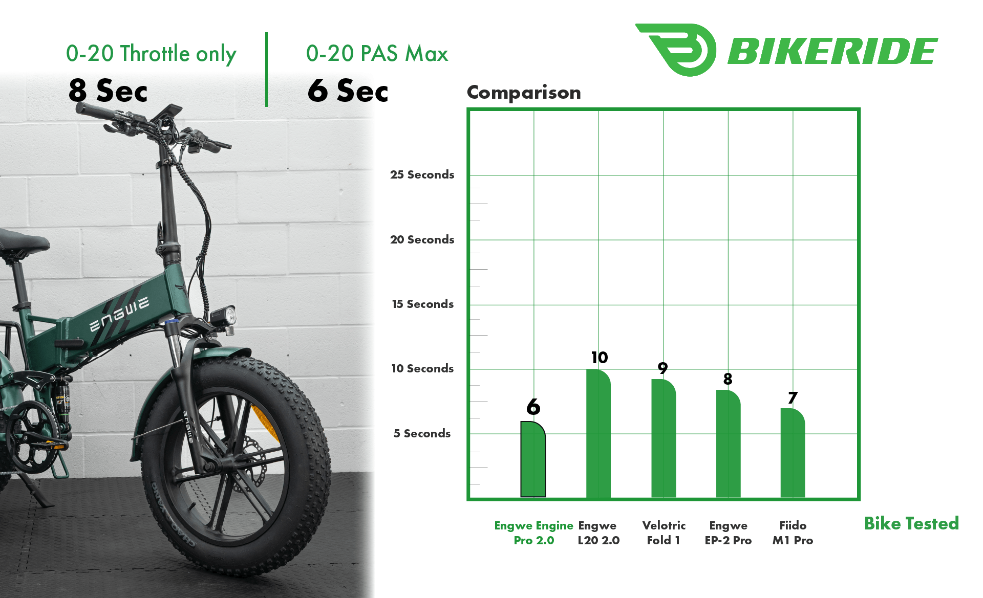

Acceleration Tests
The Engine Pro 2.0 outperformed the four comparison bikes in the 0-20 acceleration test, making good use of its 52V system and responsive torque sensor.

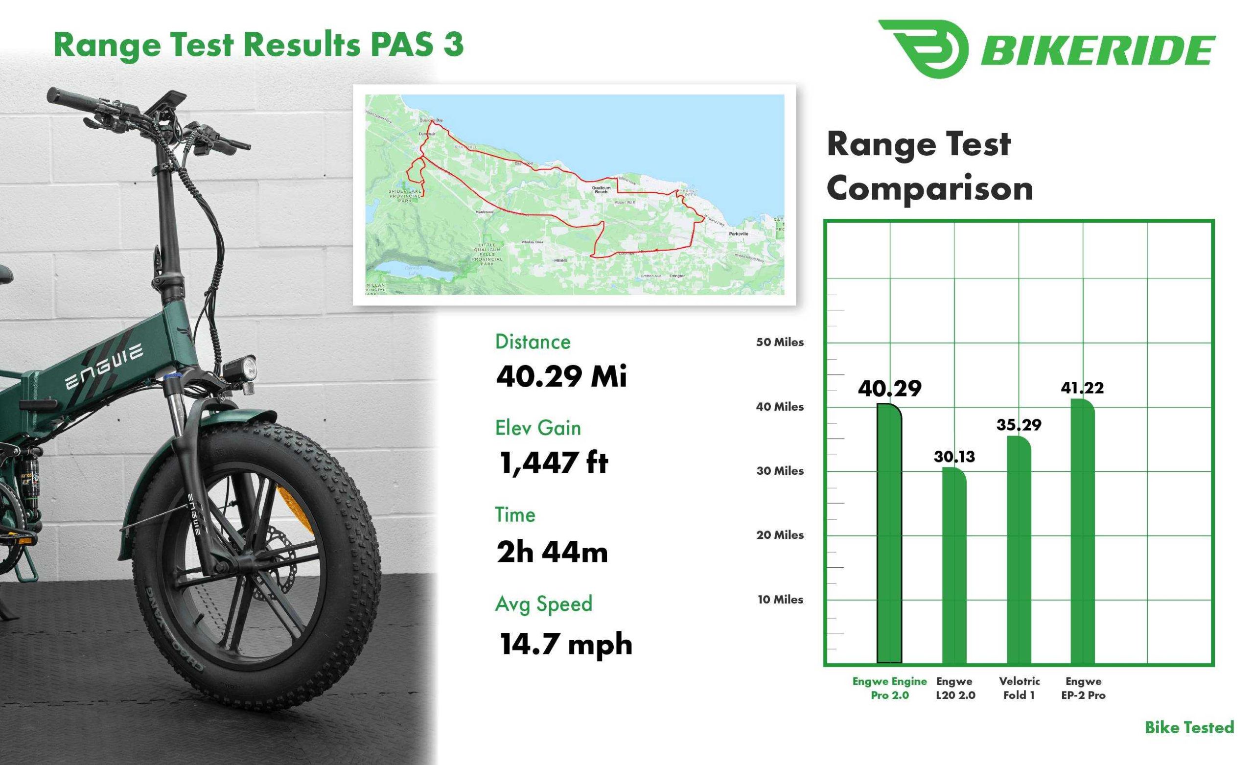

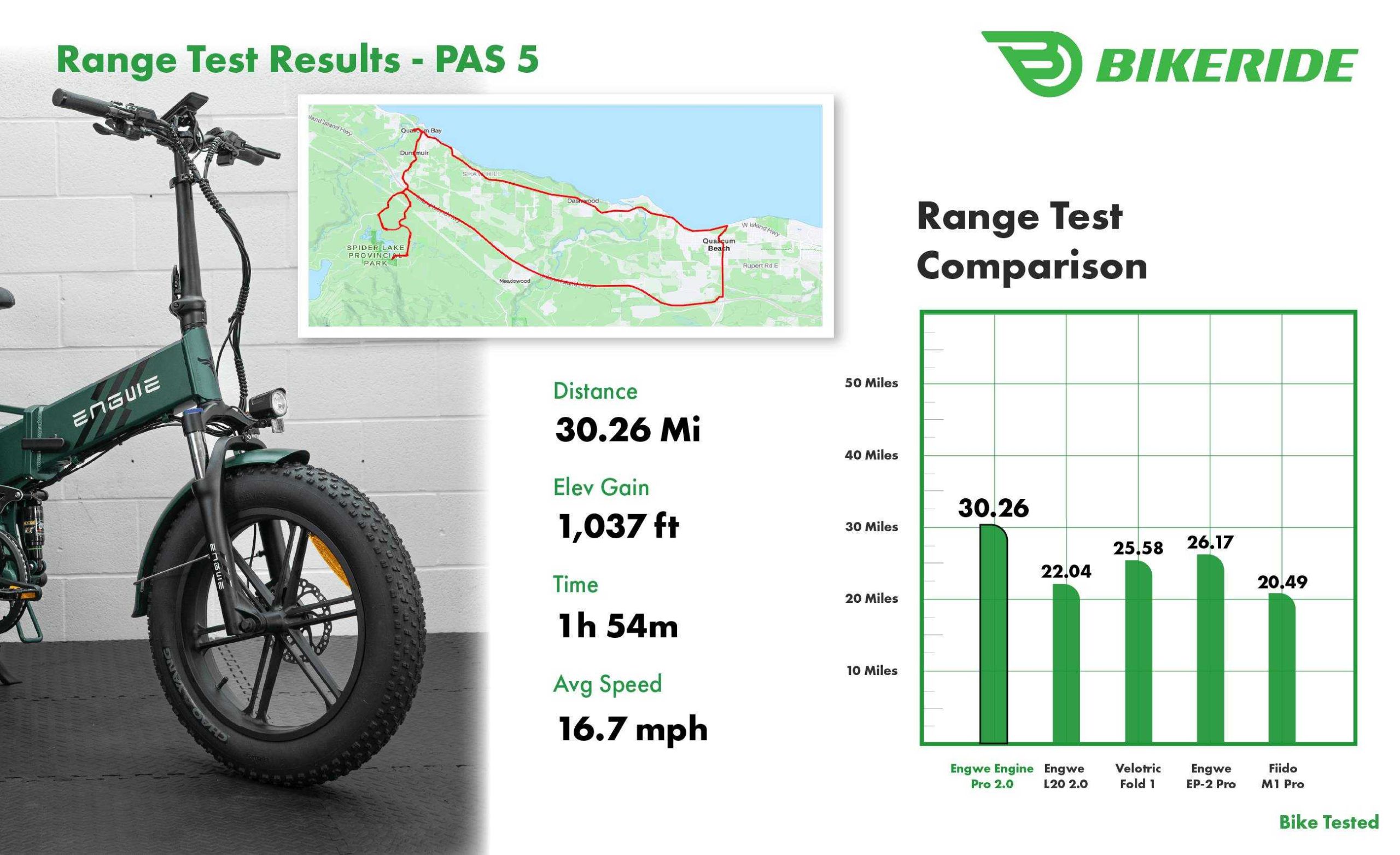

The results in the range tests were solid. In the PAS 5 range test, the bike traveling over 30 miles, beating all of the comparison bikes by between four and ten miles. However, the Engine Pro 2.0 has a much larger battery, so this makes sense.
The bike also performed well in our PAS 3 real-world range test, covering over 40 miles with almost 1,500 feet of elevation gain. The only bike to exceed this was ENGWE’s own EP-2 Pro, which reached 41.2 miles at a slower average speed of 12.6mph.

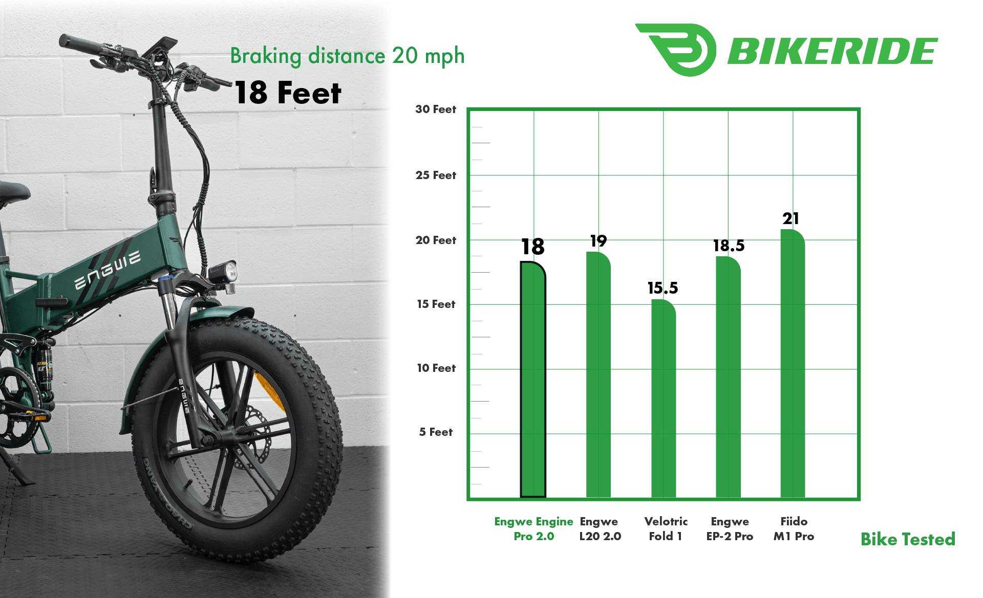

Our brake test involves stopping each bike from 20mph, and the comparison bikes had a stopping distance range of 15.5 to 21 feet. The Engine Pro 2.0 falls right in the middle of this range with its stopping distance of 18 feet, a respectable and, more importantly, safe result.

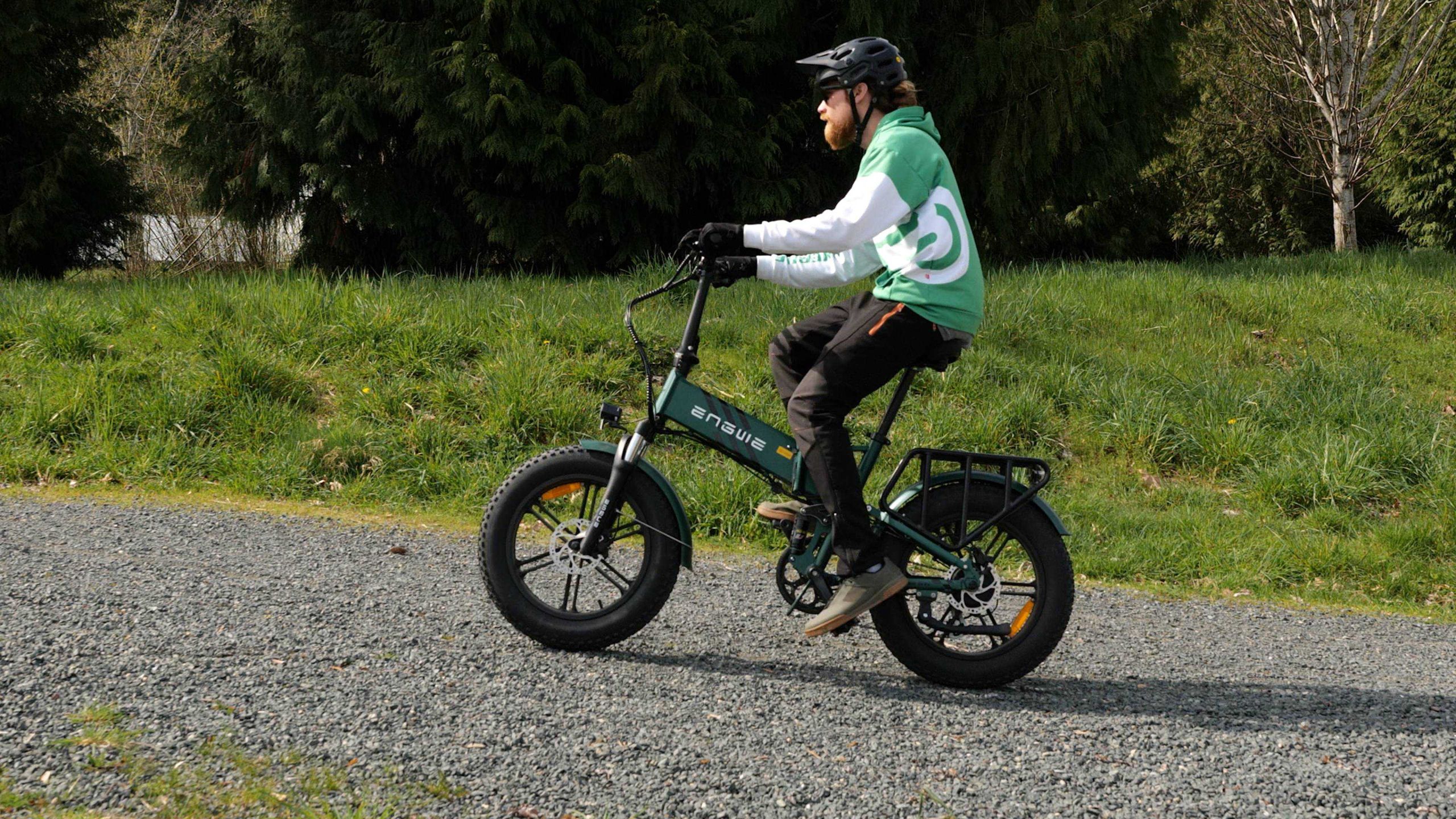

Riding the Engine Pro 2.0
The Engine Pro 2.0 has a comfortable straight-backed riding position, and I was able to get full leg extension with around one inch of seatpost left before the minimum insertion mark. With the seat set at the right height, I had the handlebar’s height set in the middle of the adjustment range, so slightly taller riders should also find a comfy position, and the 6’2 max height seems accurate.
The full suspension and fat tires make for a comfortable ride over pavement and light trails. I weigh around 175lb, and the suspension feels plush over light bumps, but the fast rebound can give a bouncy feel over bigger bumps.
The combination of soft suspension and fast rebound results in a very bouncy ride over more aggressive terrain. This is accompanied by a loss of traction, making the Engine Pro 2.0 a poor choice for true off-roading. Unfortunately, neither the front nor the rear suspension has rebound adjustment.
Overall, the bike’s upright position and ride quality over pavement and smoother trails were enjoyable, but it’s not suited to chunkier terrain.
The Engine Pro ships as a Class 3 e-bike with a 20mph throttle limit and a 28mph pedal assist limit. As discussed in the testing data, the bike accelerates quickly. Impressively, the acceleration is smooth, not jerky, as one would expect.
The five pedal assist levels offer a good spread of speed. Over level ground, the difference between each level is notable. However, PAS levels 1 to 3 lack the power needed to climb steeper gradients. Using PAS 3, each hill demands considerable effort. Those living in hilly areas would likely use PAS 4 or 5 more often, so the real-world range may be closer to that of our PAS 5 test.
The bike easily cruises at 20mph using PAS 5, requiring a steady pedal cadence and minimal effort. The 8-speed Altus trigger shifter works well, but the gearing range isn’t ideal, as I experience ghost pedaling above 22mph despite the bike being rated to reach 28mph.
I found the motor to be pretty quiet throughout testing. It produced the typical whine of a hub motor, but it doesn’t make the same high-pitched whine at full power as many other e-bikes.
During the PAS 5 range test, the first two bars of the five-bar battery indicator disappeared very quickly, but the final two bars lasted a long time, causing some range anxiety. The same thing happened in the PAS 3 test, where the first bar was used up after just two miles, even though the battery lasted over 40.
The battery also fluctuates annoyingly. For example, turning the bike off and on again causes the battery indicator to jump from four bars to five. Then, over the next few minutes, it drops to the previously displayed level. The battery display has a final low battery warning, which is an empty flashing battery bar, but the bike lasted an additional four miles after this warning appeared. Motor output slowly drops until the battery is completely dead.

Display: 3” color LCD

Saddle: K-San padded
