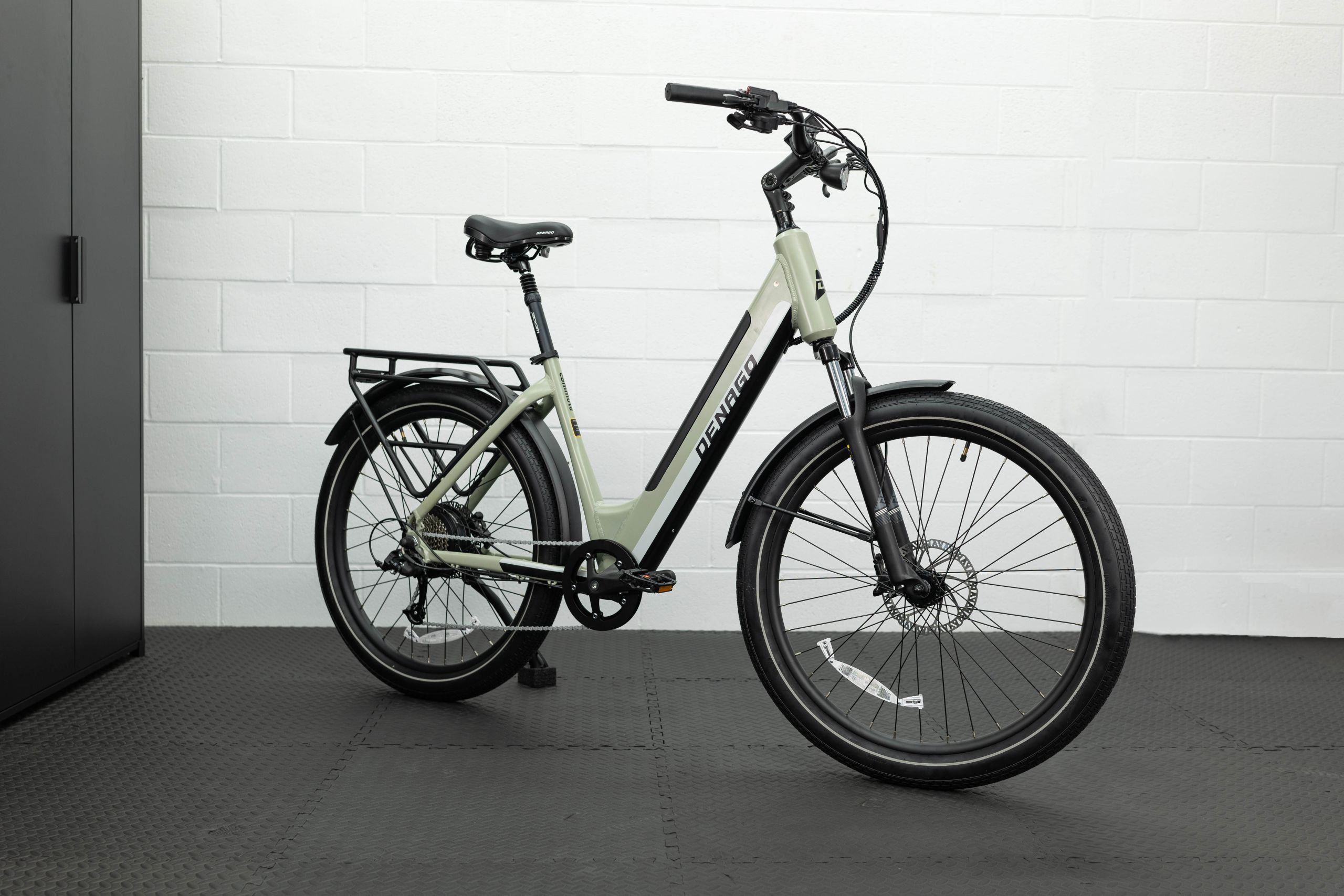

The Denago Commute Model 1 is a feature-rich electric city bike with a 500W motor, 8-speed gearing, and hydraulic disc brakes. It comes with lights, fenders, a rear rack, and 30 to 40 miles of real-world range. Fit and speed limit are easily adjusted to suit riders of different sizes and experience levels. Experts praise the comfort, stable handling, power, and ample sizing options. On the other hand, the non-integrated rear light, clunky drivetrain, and underwhelming fenders frustrate others. But overall, the Commute Model 1's specification and performance make it a strong option in this segment.
87/100 based on 5 scored reviews (9 reviews in total)
Denago Commute Model 1 – Affordable Urban E-Bike Review | BikeRide.com
Commuter-style models dominate a considerable percentage of the e-bike market. The ever-increasing selection of models makes it hard to choose the right one.

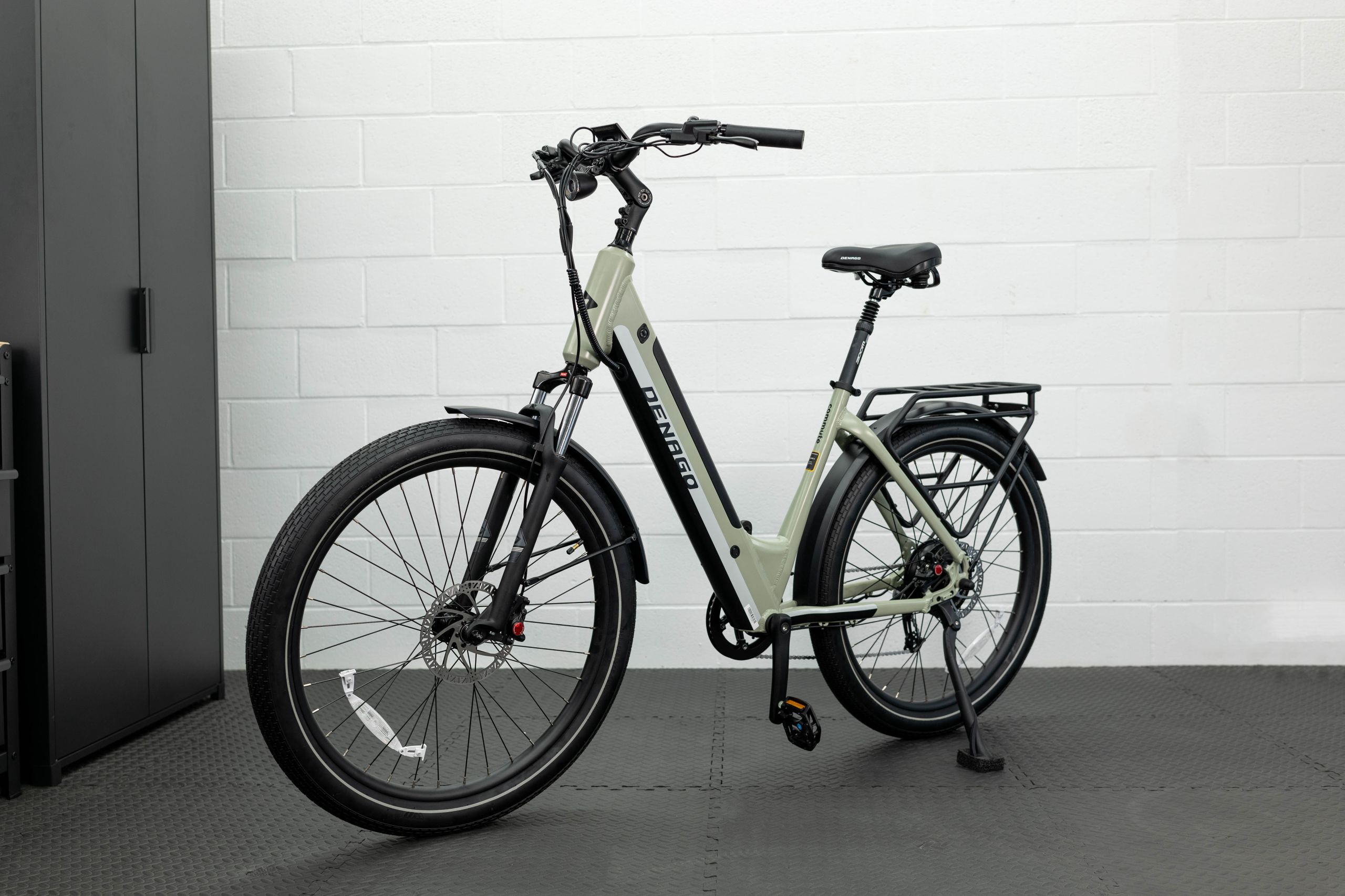

Denago is a relatively new brand, and we’re testing its Commute Model 1 Step-thru Class 3 e-bike to see what it’s capable of.
What Is the Denago Commute Model 1?
We’re testing the Commute Model 1 step-through version; a high-step version called Commute Model 1 Top-tube is also available at the same price.
The Commute is a Class 3 urban e-bike capable of reaching 28mph with its 500W hub motor. The step-through frame means it’s easy to mount and the battery is straightforward to install and remove.

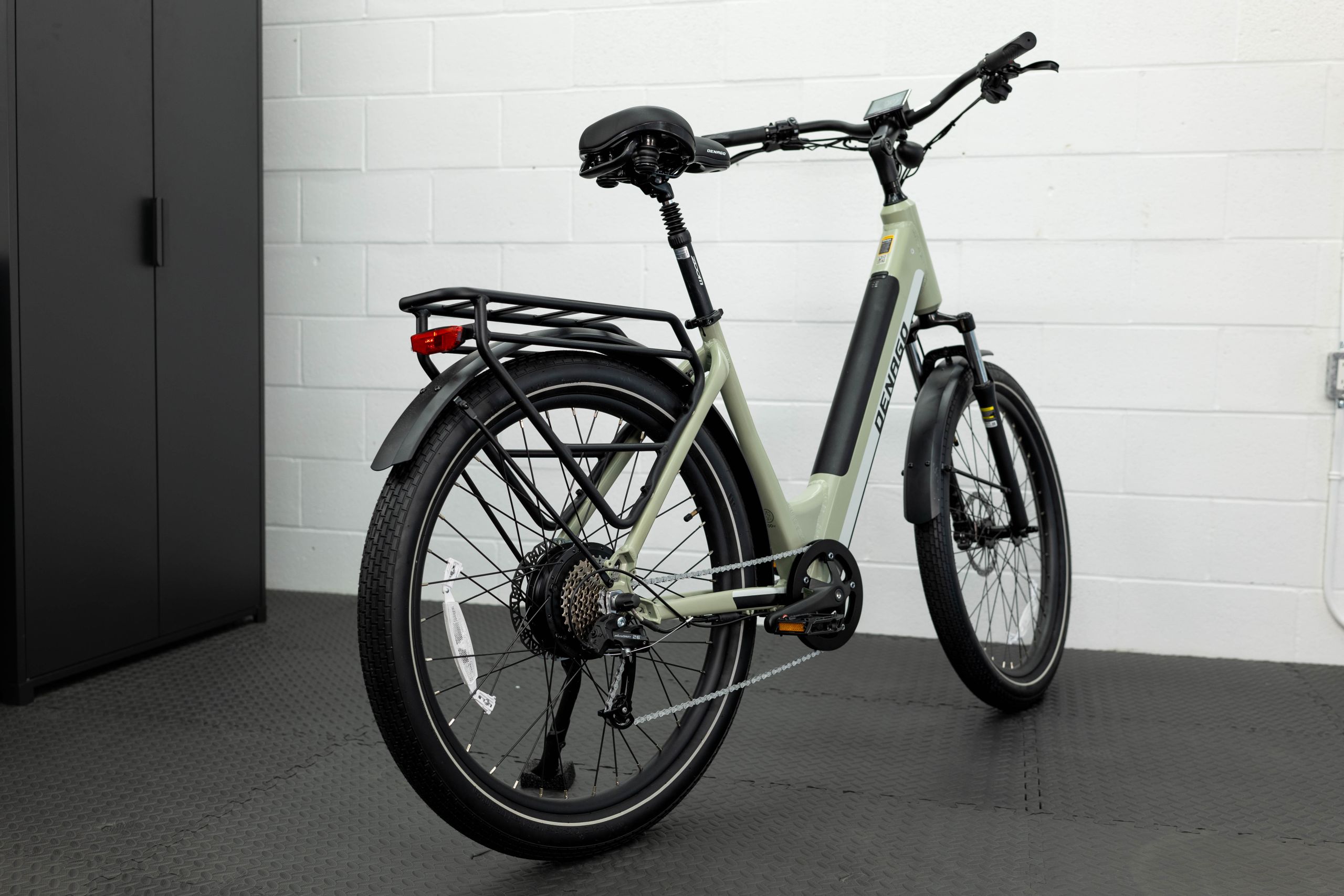

As the name suggests, this is a commuter e-bike. It features a rear rack, fenders, and lights to facilitate urban riding.
At 64lb, the Commute Model 1 is heavy, although about average for this price point and style. It feels lighter and easier to maneuver without assistance than some of the monster all-terrain bikes we’ve tested. Nonetheless, it’s best to avoid lifting or carrying it.
On paper, the Commute Model 1 is a solid package suitable for its intended ride style. Components like the 8-speed drivetrain and 11-32t cassette, 100mm coil suspension fork, and a suspension seatpost stand out.

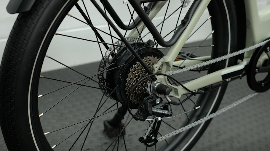

Motor
The Commute Model 1’s motor is from Shengyi, a Chinese e-bike motor manufacturer. This model is a DGW22S, a 48V, 500W motor capable of 50Nm max torque.
The motor powers the bike up to its top speed of 28mph in about 23 seconds. With just 500W, this bike is not a speed demon, but it’s peppy and responsive at lower speeds when using the pedal assist. It has enough torque and power for mild to moderate hills and will suit most commuters just fine.
I noticed a quick drop in power when attempting a hill at lower battery voltages, so steep slopes should be avoided with low battery. When facing slopes at higher battery voltages, the bike responded well, easily conquering our small and medium hill climbs.

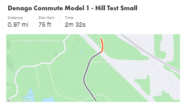

Small hill climb data
Short Hill Climb:
  • Time: 02:32
  • Distance: 0.97 mi
  • Elevation Gain: 75  ft
  • Max grade: 6%
  • Avg Speed:  23.1mph

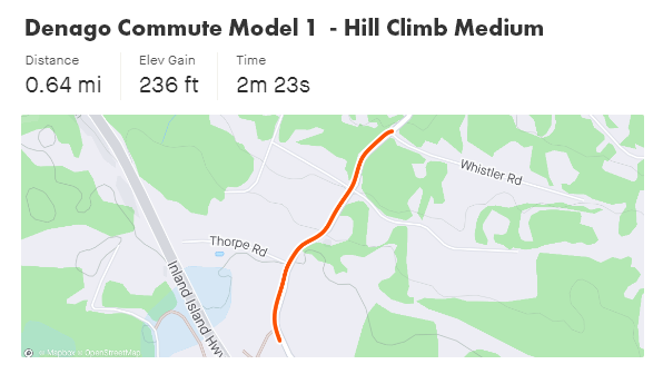

Medium Hill Climb:
  • Time: 02:23
  • Distance: 0.64mi
  • Elevation Gain:  236 ft.
  • Max Grade: 16%
  • Avg Speed:  16.2mph

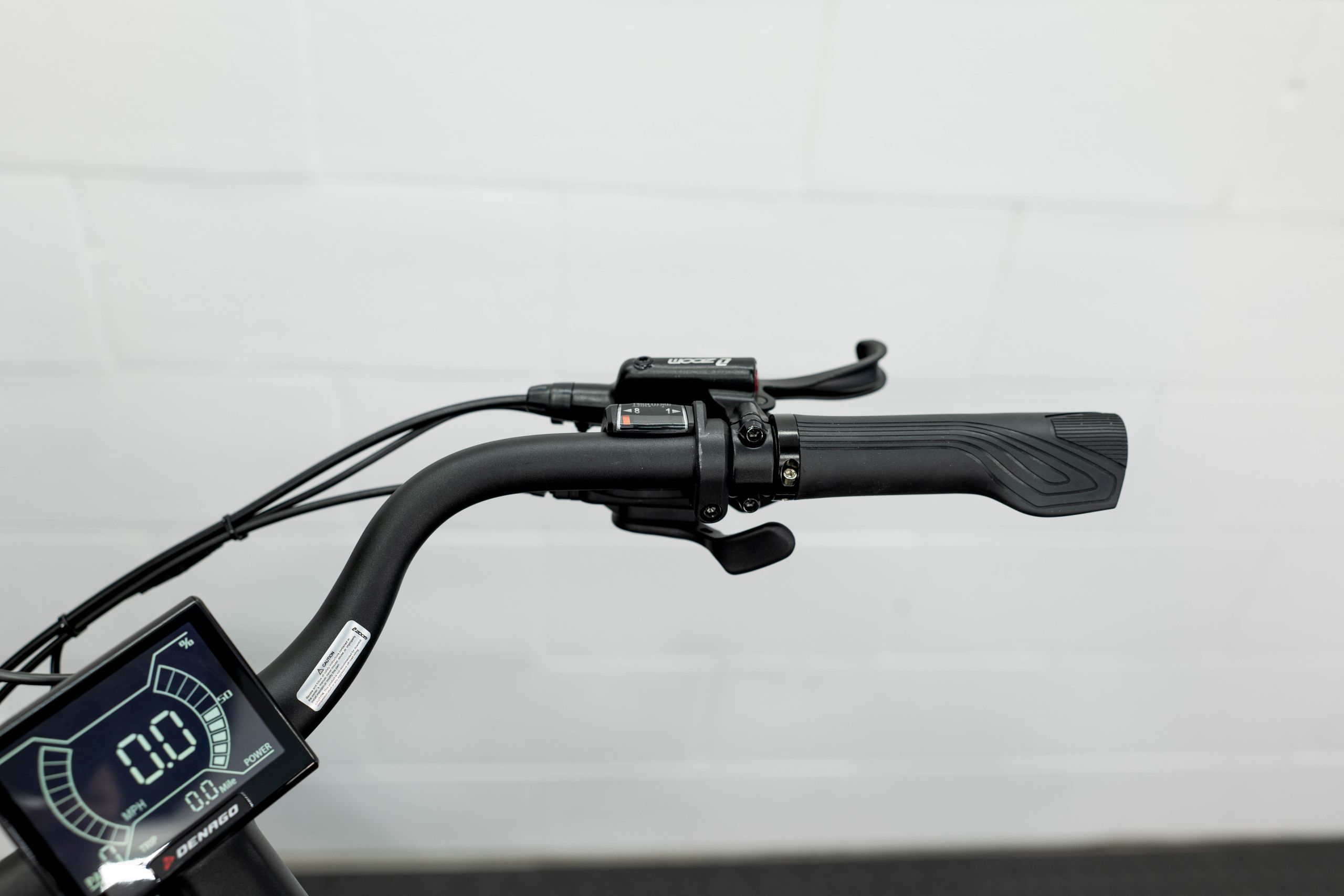

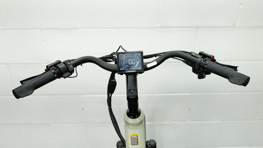

Cockpit and Control

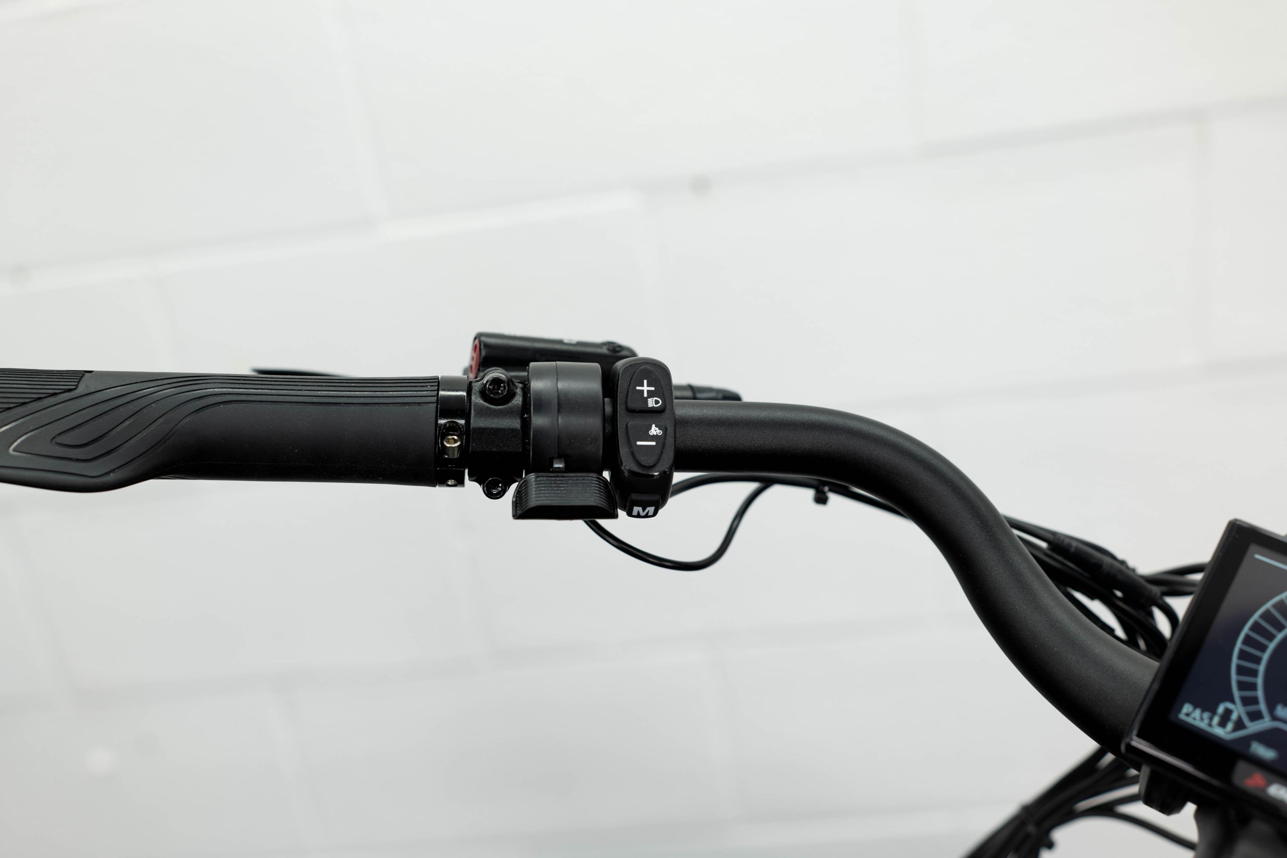

The cruiser-style bars have a slight rise and come with comfortable grips and a well-organized cockpit.
The microSHIFT trigger shifter is pleasant and offers a visual cue for gearing. On the left side, the thumb-style throttle and three-button control pad are simple to operate and control the large 3.5″ display.
The display is mounted centrally and offers easily readable information. You can select the assist level and page through different metrics, including trip, odometer, and remaining range, which is a nice feature.
The battery level is displayed as a 10-bar gauge. It’s better than a five-bar guage but not as informative as a percentage indicator.

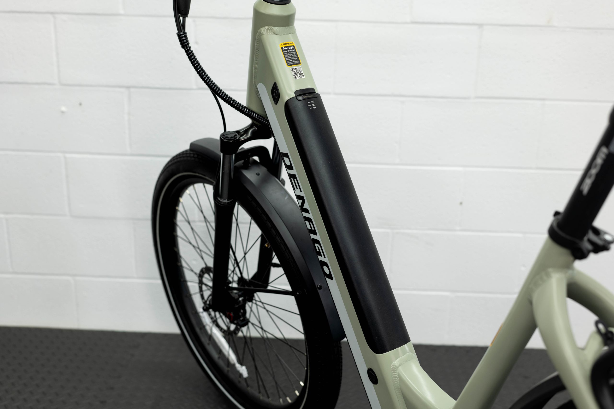

The 48V, 13.6Ah (652.8Wh) battery on the Denago is UL-certified and contains LG cells, which is great to see. However, it has a lower capacity than average for this style.
Because of the smaller battery, the Commute Model 1 performed worse in the range test than similar bikes. With a high top speed, it’s easy to go through power quickly if you are zipping around using max pedal assist. Still, the bike will handle most commutes.

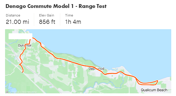

Range Test:
Range Test:
  • Distance: 21mi
  • Elevation: 856 ft.
  • Avg. Speed: 19.6mph

The battery is easily unlocked with a key inserted into the upper part of the downtube. It’s also simple to remove and install because of the step-through frame. The key isn’t required to click the battery into place; just a firm push.
The Commute Model 1 also allows for on-bike charging with its integrated charge port on the lower downtube. The charger has a 3A output, a nice upgrade over the standard 2A, and it also reduces the total charge time to roughly five hours.

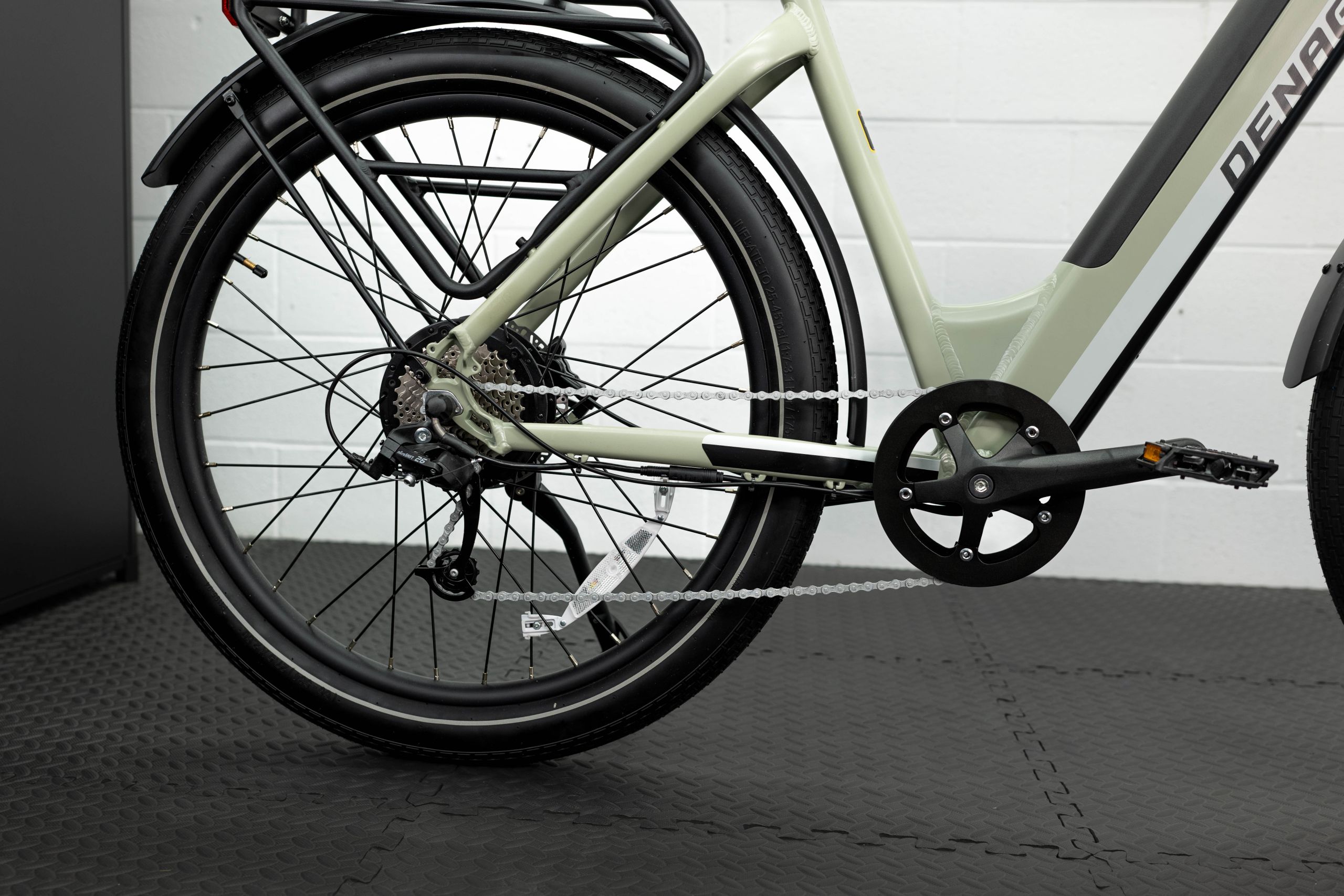

Drivetrain
A microSHIFT drivetrain assists the electric motor with an 11-32t 8-speed rear cassette. It’s great to have this additional gearing to avoid ghost pedaling at high speeds.
The microSHIFT derailleur and shifter perform well, with relatively crisp shifting that is on par with the typical Shimano Tourney or Acera. The crankset also has a double-sided guard to keep your pants from getting dirty.

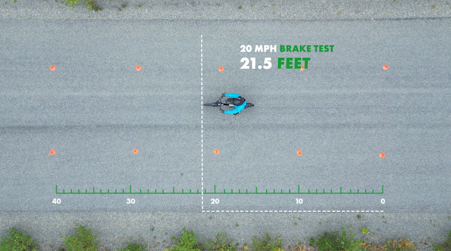

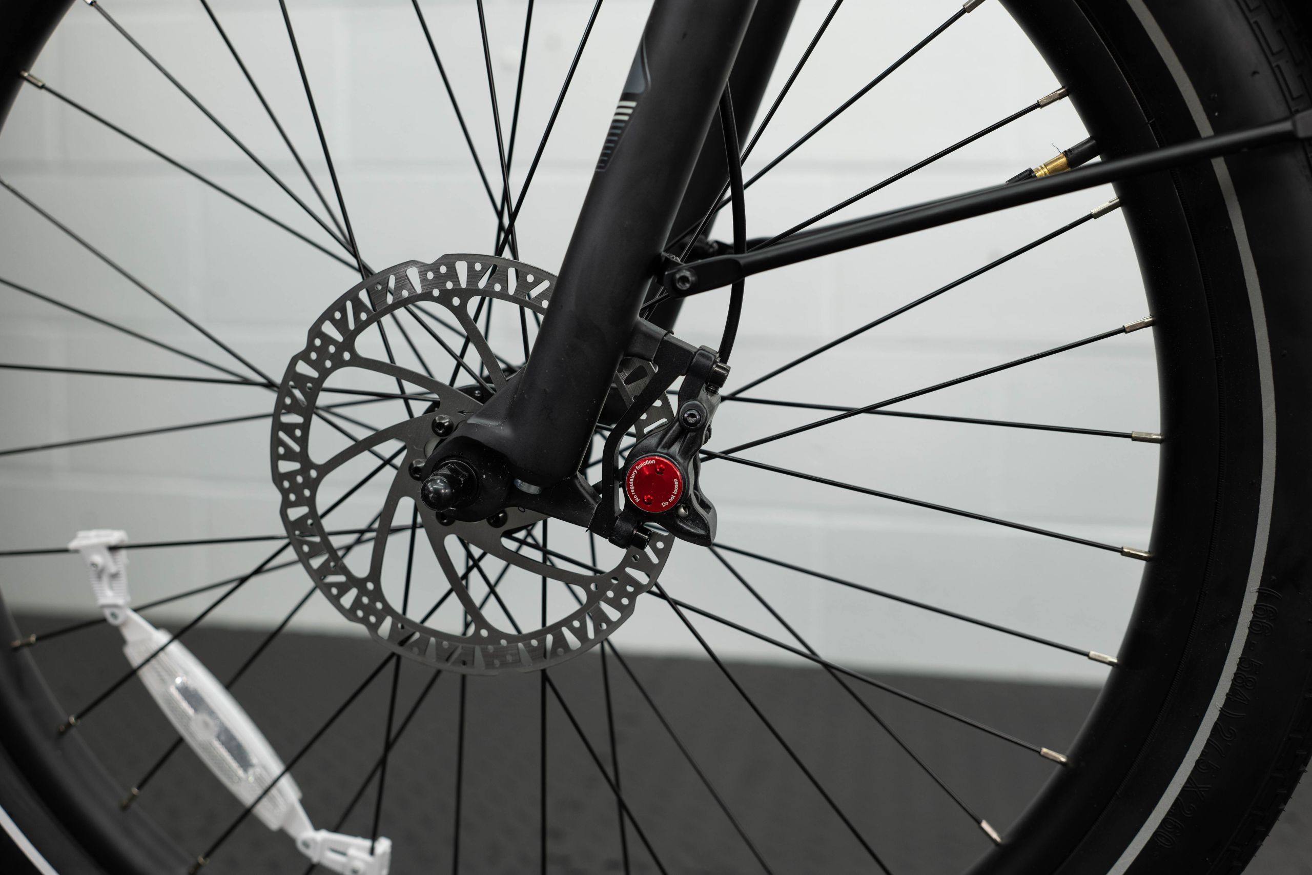

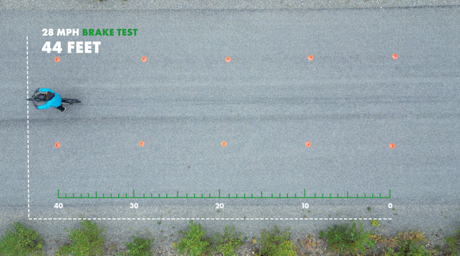

The Commute Model 1 has Zoom hydraulic brakes with 180mm rotors. The levers have a pleasant feel and consistent performance.
In our braking test, the smooth tires allowed the bike to slide a significant distance, which brought the total distance to 44 feet in the 28mph test.
The brakes are dual-piston hydraulic and offer quick response and firm pressure. So it seems this poor braking test result is mostly due to the tires, rather than the brakes.
Braking Distance Results
20 mph Brake Test
28mph Brake Test

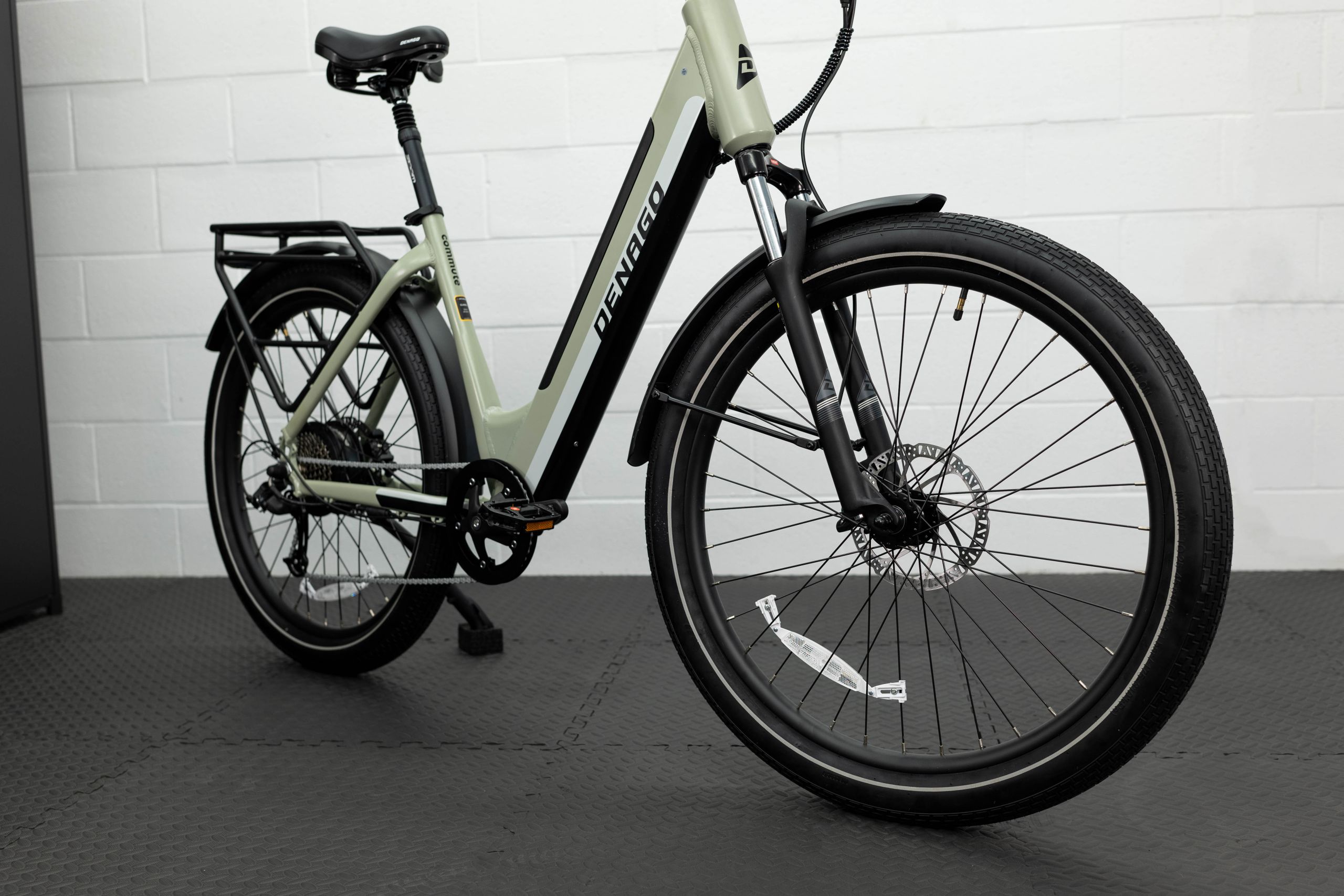

Wheels, Tires, Fenders
The tires are Denago-branded 27.5″ x 2.6″ with puncture protection and a smooth tread profile. The checkered tread pattern improves traction but is best suited to dry pavement because they do not offer much traction in wet conditions.
The 2.6″ width balances comfort and performance. It offers good traction and shock absorption in loose conditions like packed gravel while also performing well on the pavement with minimal roll resistance.
The Commute Model 1 has fenders, a great addition to keep you clear of road spray. The fenders are made from aluminum and seem like they will stand up to some abuse.

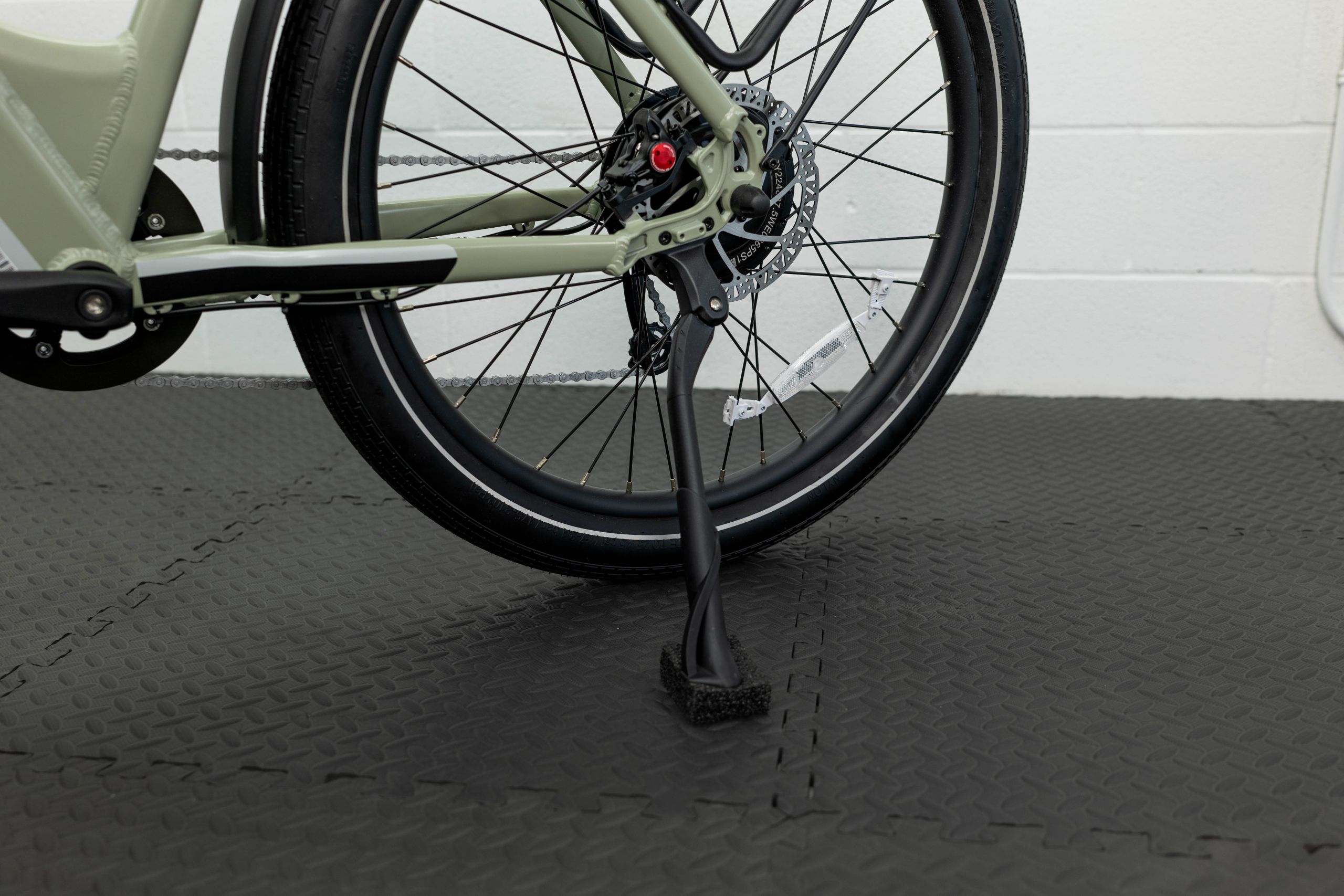

Kickstand
Like most e-bikes, the Commute Model 1 has a single-sided kickstand. It offered no issues when deployed or while riding.

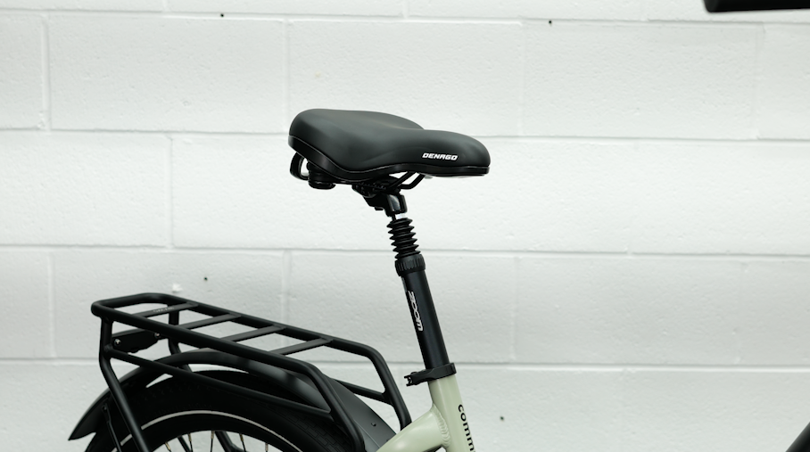

Seat
The seat is another win for Denago. I found it comfortable for cruising and pedaling. The added comfort from the suspension seatpost and polymer springs in the saddle make the ride comfortable and smooth.
The seat also has a handle on the back for maneuvering the bike and picking it up, a nice touch.

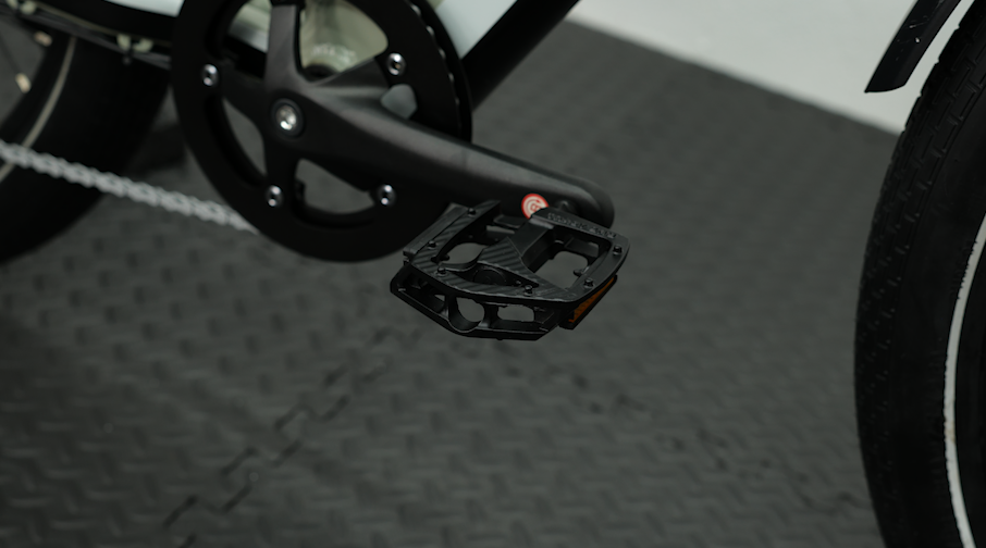

Pedals
The pedals are platforms from Tracy Zhu, which seem similar to most platform pedals on these types of bikes and offer reasonable traction with the small pegs. These pedals are basic but will get you out riding.
