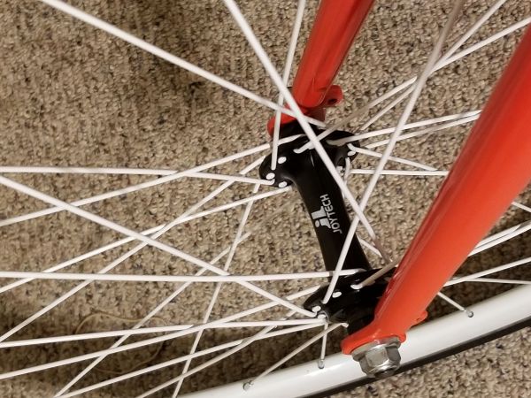

Sadly, I found it necessary to use a small, round rat-tail file to remove a small amount of steel from one forkend, in order to get an acceptably fitting front wheel.

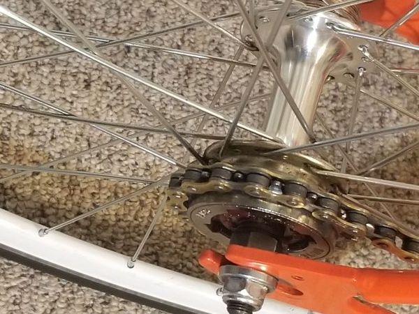

The original stock wheels consisted of a large flange 28 spoke front and 32 spoke rear that were both laced in a crossed 2 pattern using straight gauge 14mm spokes, connecting the hubs to some very rigid, unpainted 40mm deep rims, providing a most punishing and tiring ride on rough roads. The front rim, although packed well for shipping, had a dent. It didn’t affect performance, but… I promptly replaced this original wheelset with a set of small flange crossed 3 wheels from my less expensive Retrospec Harper bicycle. With those wheels the entire personality of this bike was immediately transformed, becoming far more comfortable, controllable and less punishing to my hands on rough roads.
Freewheel
The original freewheel was a dangerous contraption with pawls that became dis-engaged without notice; a very real danger, especially when you’re out of the saddle and grinding up a steep hill with your nose out beyond the front hub. The upgraded Shimano FS 1200 now performs this task without fail and in near silence.
However, I do miss the sounds of the old Maillard and Atom freewheels from 1970s French bicycles, perhaps being reassured by the clicking from the pawls that they will surely re-engage when needed.

Wheels
Freewheel

Under no circumstances would I consider using the original large flange wheels for anything other than an emergency.

With a dented rim, a dangerously malfunctioning freewheel and total lack of dealer response to these issues, I had considered destroying and discarding the original wheels, saving only the rubber and spokes.

Parts replaced as defective: Freewheel.
Parts replaced due to wear (300 miles.): None.
Parts replaced as personal upgrade: Wheels, Chainring, Freewheel.
